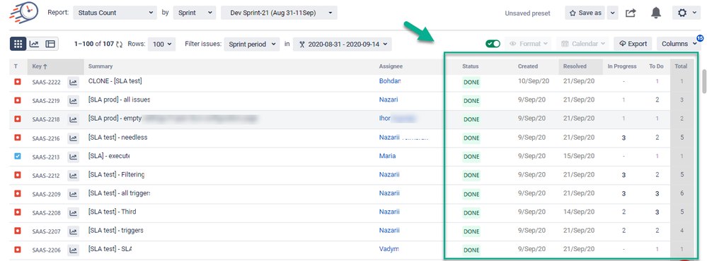

If you're ok with third-party add-ons, you can try Time in Status for Jira Cloud, which generates a Status Count report, It shows how many times an issue has been in each status. So you can track the number of transitions to each status without the additional effort.
Also, you can export a generated report to CSV or XLSX files.
It's developed by my team and is free for using up to 10 users. Please, let me know if you have any questions.
