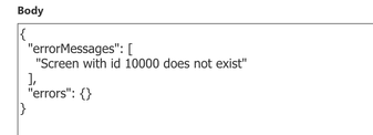

Yes, you understood my intention correctly. I got the call to work for classic projects (thanks 👍), however it fails for next-gen.
Below a section of the listed screens (GET ... rest/api/3/screens). The ones for the next-gen projects are always displayed with extra information (scope).
using the id 10000, to get the tabs for the screen 'NS: Simple Default Issue Screen", which belongs to a next-gen scrum project, the call (GET ... rest/api/3/screens/{screenID}/tabs) yields a 400 status code.
this does not happen with classic project configurations.
I haven't seen anything in the API documentation, but is it possible that this particular call does not work for next-gen projects or is this something on my end?
