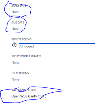

Is there a way to connect changes made in WBS Gantt-Chart to the issues? Jira tasks of any type can be edited within the WBS Gantt-Chart view but they are not connected to the actual Jira issue. If you edited the name and then you open the Jira issue, the name and other information like that the start date, end date, due date, etc is not updated. Which means that the Road Map and the Gantt do not contain the same information.

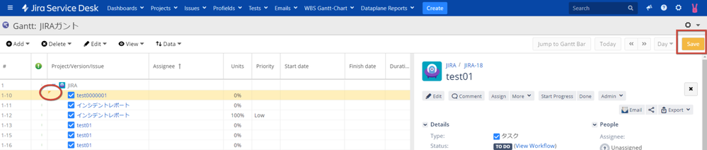

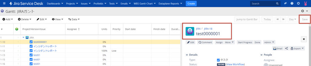

Did you click the save button?
You can edit multiple issues within the WBS Gantt-Chart view, and you have to click the save button to reflect the change.
If there are any changes, the save button is enabled.
After you click the save button and reflect the changes, the button becomes to be disabled.
Please confirm it to click the save button.

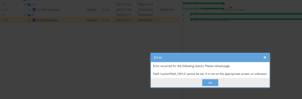

Yes I tried using the Save button, but it says "error" while saving. But later, I tried with a simplier Gantt and it worked. I don't really know why I had errors before... but thank you for your input, it helped!

The save button helps to save the WBS start and end dates but it does not save on the jira issue information that appears on my board. That means that I could actually have 2 different deadlines. I want all to be connected to be able to do scrum everyday using my scrum board and Kanban boards and track my project progress and replanning with the WBS Gantt chart. Thank you in advance.
Here is the error again, can you help to figure out what is the issue?

I understand that you are using WBS Gantt-Chart on cloud version.
"START DATE" and "DUE DATE" in the issue view are Jira system field.
"Start" and "Finish" in the Gantt view are WBS Gantt-Chart field.
They are different fields.
you can add columns of "START DATE" and "DUE DATE" on WBS, but you can't relate it to start and finish date in Gantt-Chart bar on cloud version.
Could you confirm customfield_10014?
You can access customfield_10014 with link below.
https://<your site address>/secure/admin/ConfigureCustomField!default.jspa?customFieldId=10014
Please send the screenshot of it.
Also, please confirm that customfield_10014 is placed on issue edit or view screen.

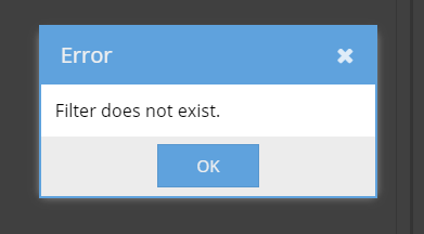

Oscar Fonseca January 28, 2020
Hi Maya,
It says: Filter does not exist.

Hi @Desi Armstrong
At the moment, WBS Gantt-Chart for Jira Cloud stores all of its information internally at the plugin, so it is not possible to duplicate fields from Jira into fields from WBS Gantt-Chart. Currently, sync between these fields is not possible.
