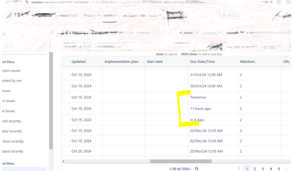

Is there a way to display exact date/time(just like in above row) instead of displaying tomorrow/3days ago etc. in Jira Filter view.

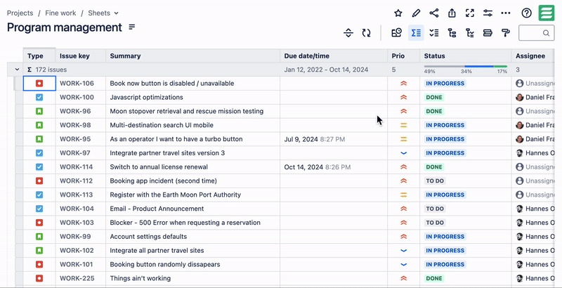

If you're open to solutions from the Atlassian Marketplace, this would work as expected in the app that my team and I are working on, JXL for Jira.
JXL is a full-fledged spreadsheet/table view for your issues that allows viewing, inline-editing, sorting, and filtering by all your issue fields, much like you’d do in e.g. Excel or Google Sheets. It also comes with a long list of advanced features, including support for (configurable) issue hierarchies, issue grouping by any issue field(s), sum-ups, or conditional formatting.
Plus, date and date/time values are always shown as absolute values as expected, like so:

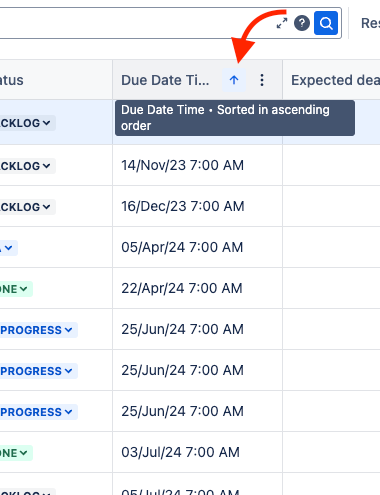

I'm experiencing the same issue. I'm not sure if there have been any recent updates related to this.
I discovered a workaround - if you have multiple issues, you can sort that field in ascending order, and then it will display in the absolute format. However, in my case, where there aren't many issues, I don't know what to do.
