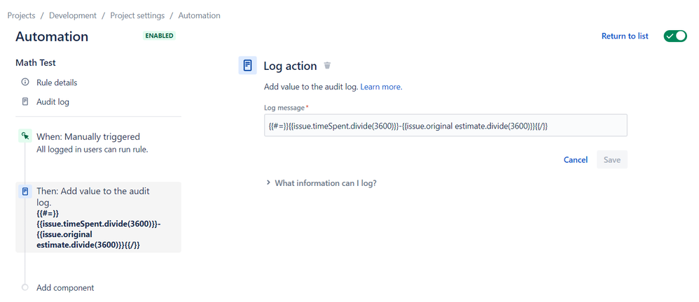

I created a simple (manual) automation, that just logs the result of the calculation, to test this idea. Here's what my super simple automation looks like:

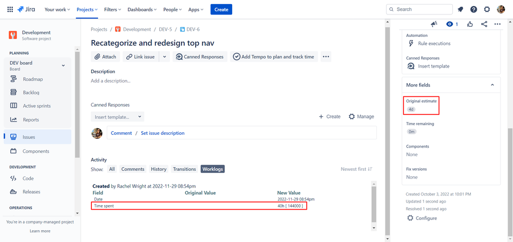

Here's my sample Jira issue with an original estimate of 4 days and a worklog of 5 days. Note: Jira shows 5 days as 40h. (5d x 8h (my application's default) = 40h)

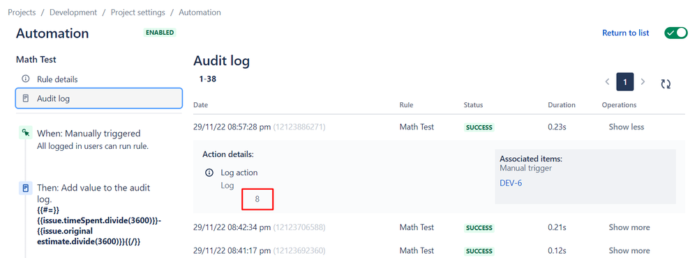

And there's the result showing the number written to the log.
In the above screenshot, the difference between 4d and 5d is "8" meaning and excess of 8 hours over the estimate. If there was a surplus of 1d, the result would show as "-8".

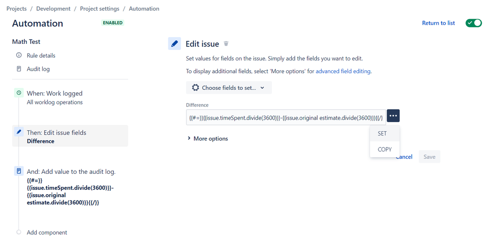

Automation rule specifics:
Here's how I set up my automation.
  • Trigger: Work logged
    • For: All worklog operations
  • Action: Edit issue
    • Choose fields to set: [your custom number field]
      • Then click the ellipses ("...") next to the empty text field and choose "SET"
      • In the empty text field, enter the desired calculation.
Here's the calculation I used: {{#=}}{{issue.timeSpent.divide(3600)}}-{{issue.original estimate.divide(3600)}}{{/}}
Here's what my completed rule looks like:
Additionally, I chose to post the calculated result to the log, just so I can check my math. The log action is is shown in the above screenshot and the result is shown in my Nov 29 message.
