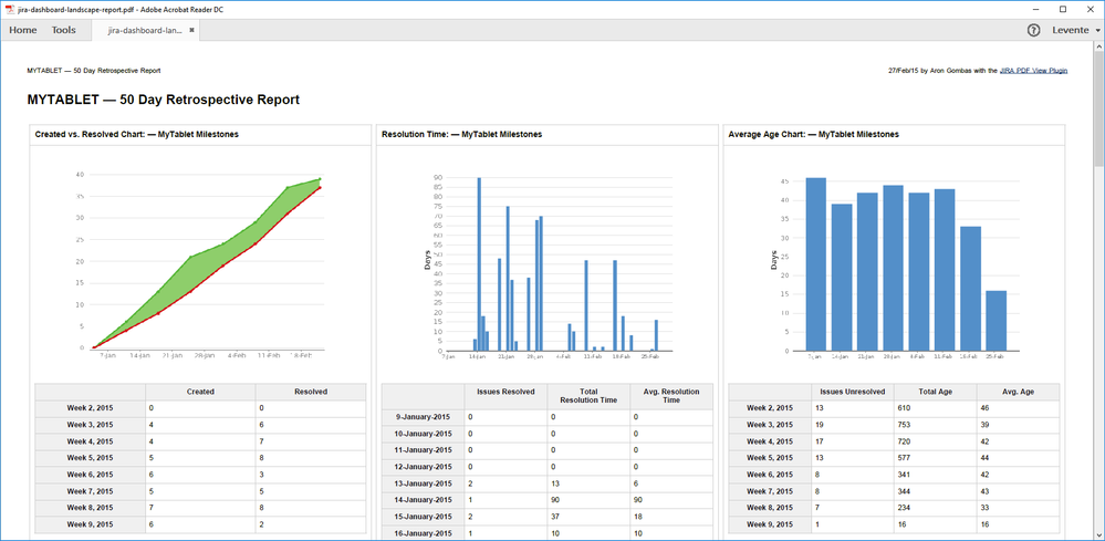

There is no built-in feature for this, but you could approach this using the Better PDF Exporter app.
As you can embed reports (to a large extent) in dashboard gadgets and you can export dashboards to PDF documents, you can capture reports in PDF files. Then you can compare any two PDFs.
jira-dashboard-pdf-export
See: http://www.midori-global.com/products/better-pdf-exporter-for-jira/documentation/dashboards#exporting-reports
I am not sure if it is practical in your use case, but it may be.
