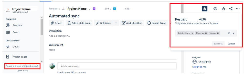

I need to find all the restricted issues in a team-managed project. I tested using "Level is not Empty", but no luck. Any suggestions greatly appreciated.
Hi Jennifer,
I am not aware of Issue Security being available for Team-managed projects.
Hi @Jennifer Choban - HeroCoders
Issue Security does not work with Team-managed projects. You can check Project access in the project settings / Internal access.

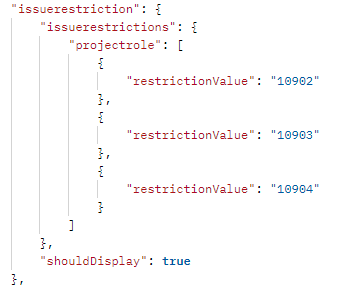

I dont think there is a way to query from the UI. Hopefully someone can share some ideas.
As an alternative you can make an API call for these fields:
I removed some data but this is how the restriction looks like:

Hi Erik,
I tried that, but when I tested it on a team-manaed project, it didn't work (I restricted an issue and then ran the query. The restricted issue didn't show up. But restriction.Value might get me somewhere.
Thanks for your help.
@Erik Beltran This worked for me in a team managed project to identify the issues that had restrictions.
