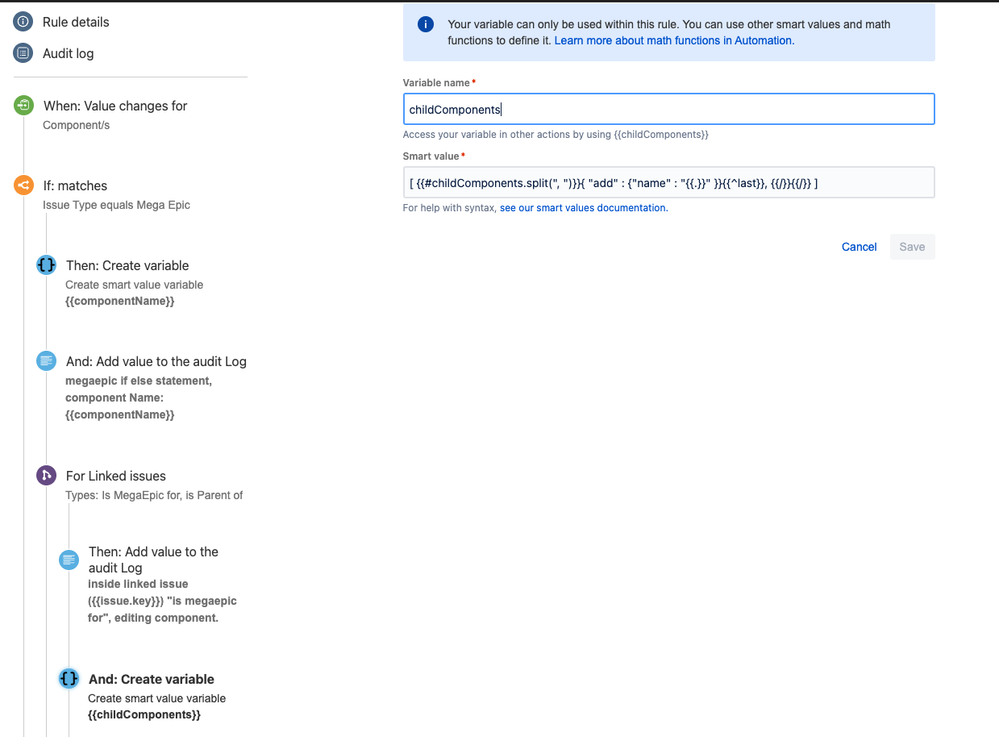

What I tried earlier was what you described. I had a logger action that had this, below.
"inside linked issue ({{issue.key}}) "is megaepic for", editing component. field: {{component/s.fieldChange.toString}} {{components.fieldChange.toString}} {{component.fieldChange.toString}} {{fieldChange.toString}}"
I then changed the component in the epic and I manually triggered the automation. This was the log output:
"inside linked issue (BIZ-56729) "is megaepic for", editing component. field:"
@mattics phi Instead of scheduled trigger as your first step, you need to change it to use "Field Value Changed" trigger and choose component/s as a field to watch. Then in your first log action under if.. use {{fieldChange.toString}} to capture what was changed..
As mentioned, we can only do this for go forward changes, not to those where changed already applied.
Awesome, thank you @Kalyan Sattaluri ! I got it working now :). What was missing was the trigger. You were right, I needed to listen to when a component value was changed. Only then did it work! I'm going to see what I can do about the second part of your comment since I don't want it to overwrite all existing components!
Where would I added the second condition? After the branch? I got an empty output I had when I tried your code

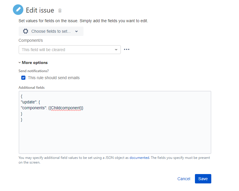

Your last variable, Childcomponent should be:
[ {{#componentName.split(", ")}}{ "add" : {"name" : "{{.}}" }}{{^last}}, {{/}}{{/}} ]
Then you go to -> edit issue and go down to additional fields and put in below JSON to only add and not replace.
"update": {
"components": {{Childcomponent }}
Sorry for my tardiness, I was only able to get to this now. And of course, this is perfect, thank you @Kalyan Sattaluri ! Works flawlessly :)
