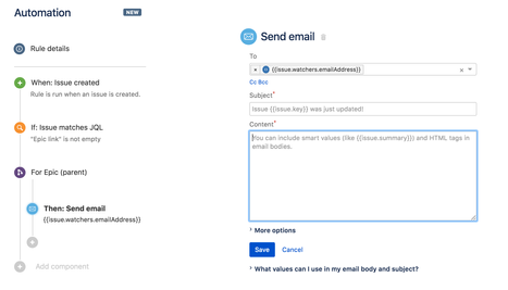

If i got it right, I would like to suggest you try Automation for JIRA plugin. You can simply customize the automation below to achieve your need:
Here's the background of the rule configured above:
- When the issue is created, the automation triggers and check if it has any Epics linked to it
- If it has, it will send a notification for all Epic watchers
P.S: Use the Smart value {{issue.watchers.emailAddress}}
to reference the e-mail address of your Epic watchers.
Let me know if this information helps!
