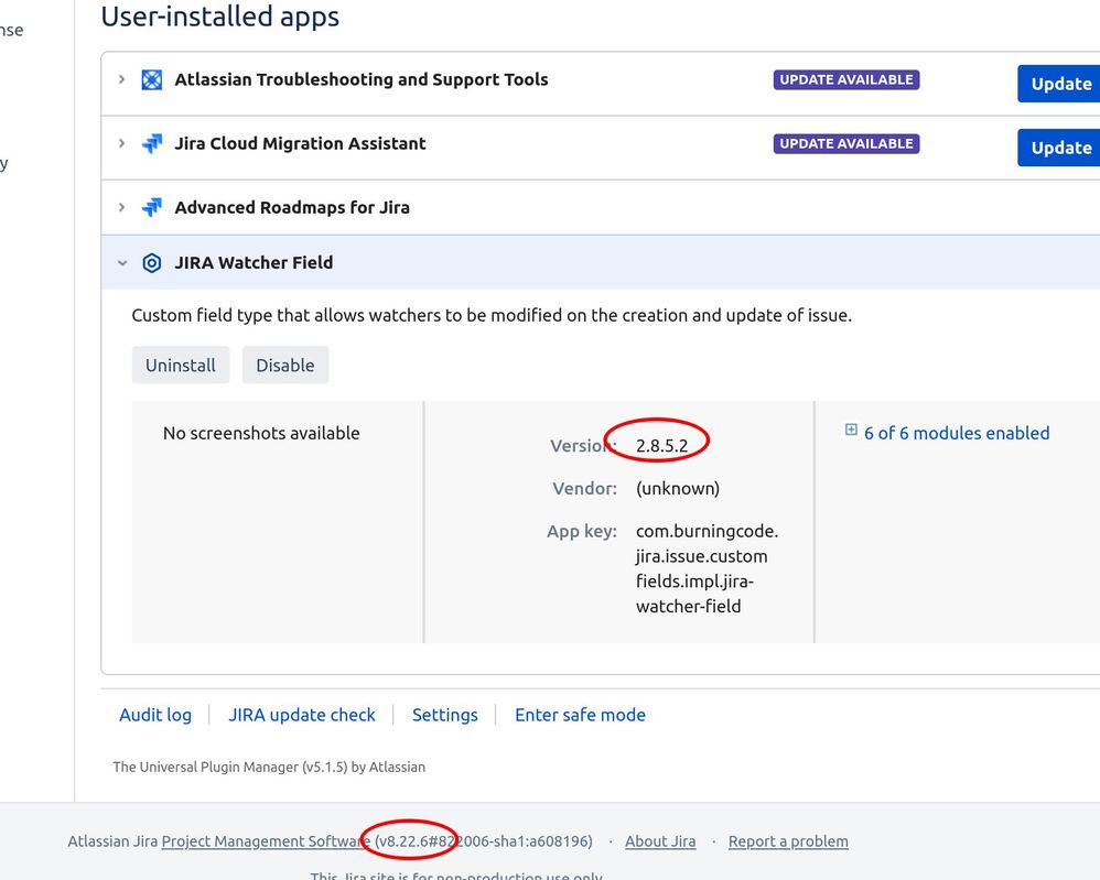

This is causing issues for me in 9.4.7 - I have downloaded Version:
Hi @David Yu
I downloaded 2.8.5.2 from https://bitbucket.org/superoni/jira-watcher-field-plugin/downloads/ - it worked for me on 9.4.7 perfectly.
Thanks a lot

Unfortunately, this add-on is causing chaos in our upgraded test instance.
Sami S.
@Sami Ahmed Shaik what version are you currently using?
@David Yu Thanks for the response,
We are currently using Jira Server v8.22.6 & Jira Watcher Field v2.8.5
Sami S.
Sami, you are welcome to test my patched 2.8.5.2 version against 8.22.6 at your own risk.
Thanks for the patched file, I uninstall and re-install with the patched file, got the following error
Sami S.
Sami, not sure what the problem could be. I tested locally on new 8.22.6 install and it worked for me.
Let me try by clearing the cache from the Plugin folders and will share the results.
Sami S.
Same error even after clearing the plugin cache. Any other solution you could recommend us?
Sami S.
Anybody can help with that issue?

Hi Matis,
If I understand correctly, you say that the version
is jiracomponentwatcher 2.4 working fine on Jira Sever 9.1?
Is it possible to get the fixed version 2.8.5 as 2.8.6 over Atlassian Universal Plugin Manager?
When not, please send me also the fixed 2.8.5.
Regards Harald
