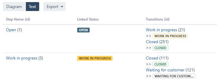

This didn't work. Apparently the transition IDs are not available. Here's the workflow image from my jira instance in text . IDs are not shown on the image.
@Benjamin Paz You are in view mode of the workflow. If you want to see transition id you must edit the workflow in text mode. Then you will see Transition (id) field.
@Nic Brough _Adaptavist_ Thanks for the info
