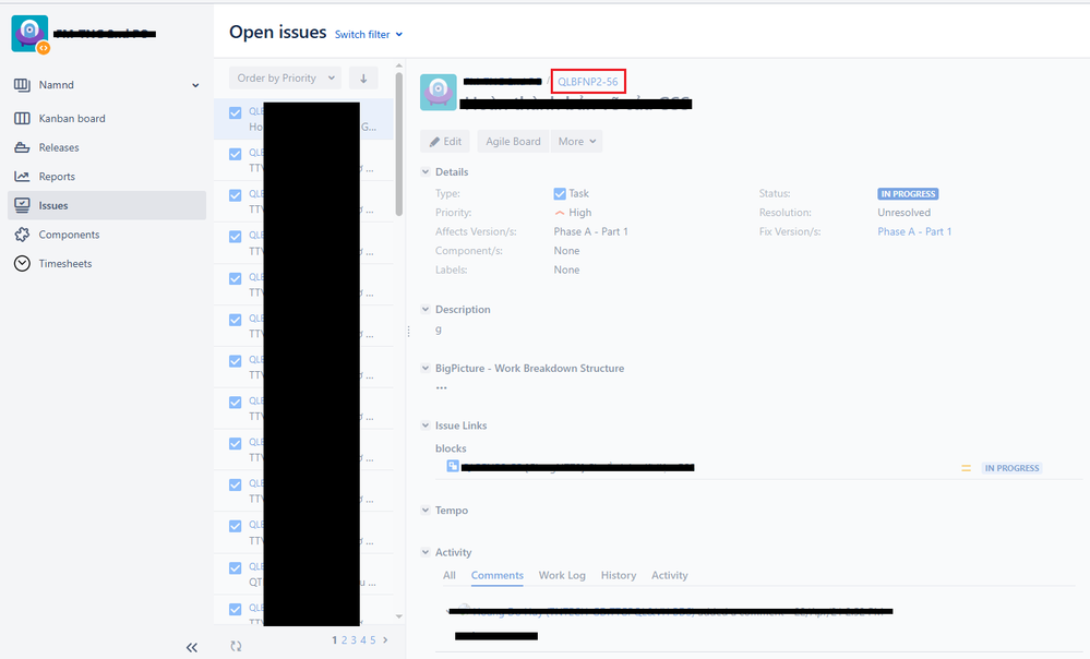

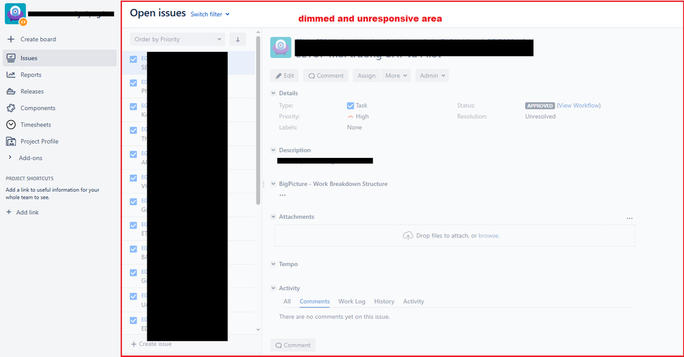

Previously, we deployed Jira on Azure and everything worked fine. However, a few days ago, we decided to migrate Jira to our on-premises Data Center, and we’ve encountered an issue:
All users can access projects normally and can view issues using filters. However, they are unable to interact with issues (e.g., select, edit, or transition them). The issue screen appears dimmed and unresponsive.

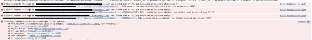

It turns out the issue was not related to the Server ID. After enabling network capture in the browser, we discovered HTTPS-related errors (see image below for reference).
We then made some configuration adjustments to Tomcat and Nginx:
Tomcat Configuration:
<Connector port="8080"
relaxedPathChars="[]|"
relaxedQueryChars="[]|{}^\`"<>"
maxThreads="150"
minSpareThreads="25"
connectionTimeout="20000"
enableLookups="false"
maxHttpHeaderSize="8192"
protocol="HTTP/1.1"
useBodyEncodingForURI="true"
redirectPort="8443"
acceptCount="100"
disableUploadTimeout="true"
bindOnInit="false"
proxyName="your domain"
proxyPort="443"
scheme="https"
secure="true"/>
Nginx Configuration:
NGINX
proxy_set_header X-Forwarded-Ssl on;
proxy_redirect off;
After these changes, all Jira features are now functioning correctly.

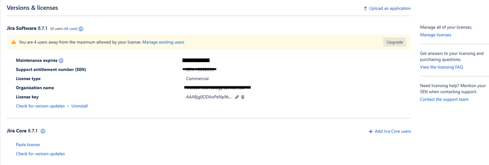

Do you have an active license on that instance? It sounds like that is the issue?
Thank you for your quick reply.
We are currently using a commercial license.
Could you please confirm whether we need to obtain a new license key after changing the server?
Thank you again for your support.
@John Ken To me the symptoms look like an "invalid/expired license" problem.
The license has an identifier in the format ABCD-ABCD-ABCD-ABCD. I could imagine that the migration changed this... (e.g. if it depends on the physical machine that hosts Jira).
If it changed, then the old license (tied to the old ID) will not work on the new server, and as a consequence Jira will turn to "read only" mode.

According to information from the Atlassian team, there should be no issues with Jira when changing servers:
Atlassian Community Reference
In our case, we performed a server migration, not a fresh installation.
Additionally, we tested applying an invalid license key, and Jira immediately flagged it and blocked the action. Based on this behavior, I believe our current license is still valid.
Please let me know if you think we should verify anything else.

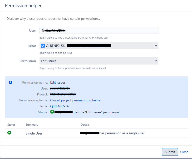

Hello @Brant Schroeder ,
What does PERMISSION INSPECTION says? Try checking for a affected user and issue wherein they are unable to EDIT?

I’ve checked the Jira license, and everything appears to be in order.

Try as:
Project -> Settings -> Permission -> Permission Helper -> Select any issue of that project -> Affect user and submit
Let us know the result of that.
Hi Piyush,
I'm not sure if I followed your instructions correctly.
Here is the result I got—could you please take a look and let me know if I missed anything?
Thank you!
Thanks for the info. So though it is saying that edit permission is available; can you check browse permission as well?
