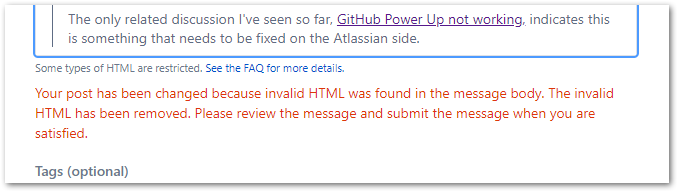

Meta: I had to press submit post on this 3 times before it was successful. On the 3rd time was a notice about invalid html. As far as I can tell what's written above is still correct, but I may have missed something. During the initial composition I tried several ways to stop the blockquote format and resume normal for the rest of the post but was not successful.
