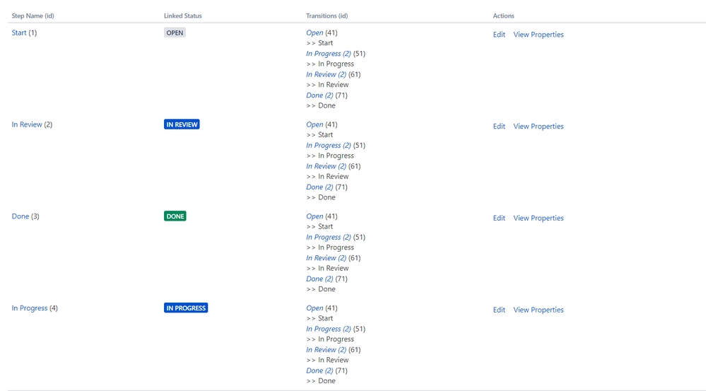

For workflow, you could set the step id and associated transition id as shown below
Now that your workflow will also have its own id, you could then associate this id with the issue type
