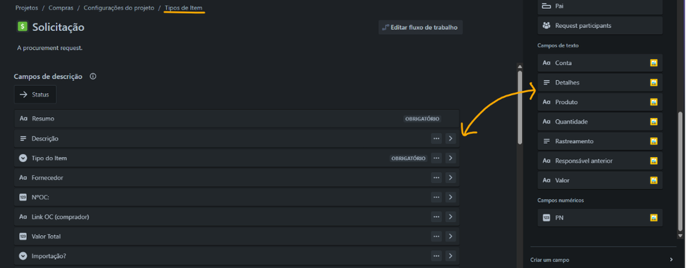

Raynara Alves Blaque April 10, 2025
We are using Businness Project, managed by team.
I just removed the field here, in the project configuration -> issue type.
However, when I put it back, it doesn't haven't the same content.

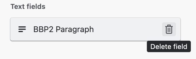

After dragging the field to the column on the right did you at any point click on its Trash Can icon to completely delete it?
That would delete all data that had been stored in that field also. Creating a new custom field with the same name would not restore the field.
