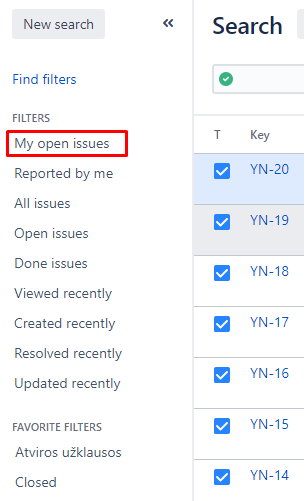

When a worker looks for issues, he can choose filters:image.png
If he uses My open issues filter, he also sees issues, which are associated but not assigned.

My open issues reports "assignee = currentUser() and resolution is empty", it does not look at team.
(Also, this list of pre-defined filters is nothing to do with "worklog" so I'm wondering if you've used the word for the wrong thing, or whether you really are thinking of worklogs)

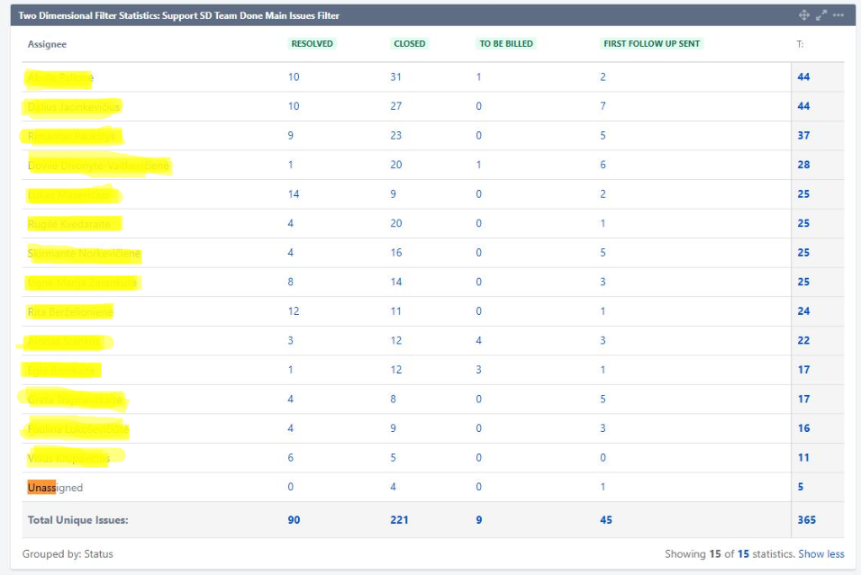

User also mentioned, that he can see unassigned issues here:image.png
What I need to find out is it possible after associating issue to a team,  to make it visible only for people, who are members of a team?
