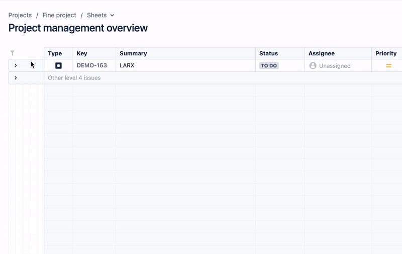

if you're open to solutions from the Atlassian Marketplace, here's another app that you might like: JXL for Jira.
JXL is a full-fledged spreadsheet/table view for your issues that allows you viewing, inline-editing, sorting and filtering by all your issue fields. It also comes with advanced features such as support for issue hierarchies, issue grouping, sum-ups, and conditional formatting.
For issue hierarchies, JXL allows you to use any combination of built-in parent child relationships and "custom" parent-child relationships, based on issue links.
This is how JXL looks in action for a 5-level hierarchy:
You probably know that you can trial any app for free for 1 month, so if an app is an option for you, I recommend trying out a few and choosing the one that works best for you.
Disclaimer: I work on JXL.
