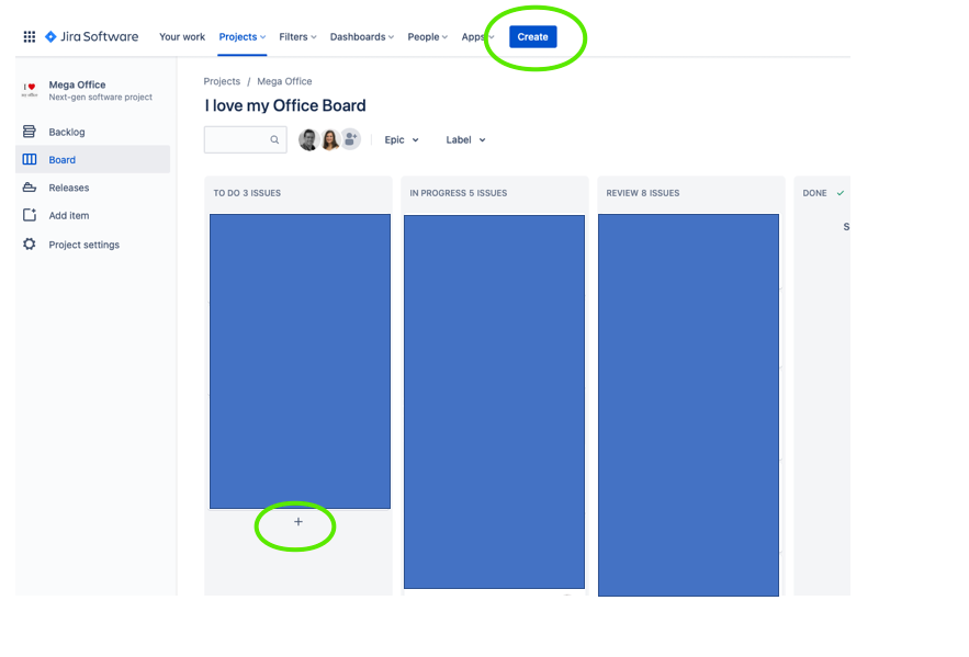

I do not get the point the "+" icon is on the Board and then the issue gets created in the Backlog. I would also like to create them directly in the Board and cannot find a solution.

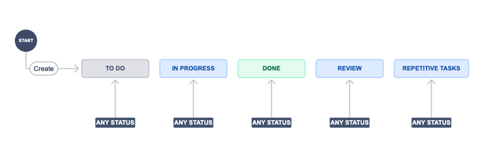

can you provide more context? The situation has changed a bit. You can create issues directly on the board in all columns in Next-Gen projects. It all depends on your project configuration (= activated features). Are you running sprints? Then you won't be able to do that which is logical. Are you not running sprints but have the backlog activated you can decide where the issue will be created. It also depends on your underlying workflow in the project because the issue will always be created with the initial status and then transitioned (if possible) to the target status of the column. It is required to select "Allow issues in any status to move to this one" for the specific status in the configuration.

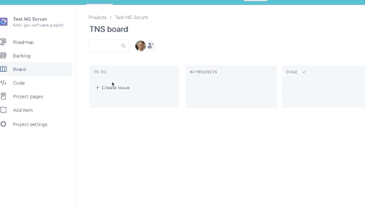

Hm okay. I just tested it and created a new NG project using the Scrum Template, deactivated the Sprint feature, and can create issues on the board in any column of my board. So there's must be something missing in your configuration that affects the behavior. Do you have any idea? :)

This same issue is occurring for me on a next gen project as well.  Create an issue using the large blue Create button at the top of the Board.  The issue is created in backlog but not added to the Board.
Note: I had the Sprint feature enabled in the past, then disabled it.  Not sure if that has any effect on this.  Thanks!

Hey @Sloan Morris, you mean the big "Create" button in the top navigation bar? This one will not create issues in the board.
That's the global function to create an issue everywhere in the system in any project you have access to. So the issue you create there will be visible in the backlog then.
To create an issue right in the column on the board (and skip the backlog and transition to the target status!), you have to do it in the column itself (see the gif in my former post). So you don't see the "+ Create issue" in the board as well?

Yes for me still the same I create an Issue either in the top or in the column and it will be created in the backlog and not in the column. Pretty annoying, but I gave up on it.
Sloan Morris
March 24, 2021
@Max Foerster - K15t Thanks for the explanation of the big blue create button.  I do see the + Create Issue on the board columns as well.  With your explanation, everything is working as expected for me now. Thanks!
