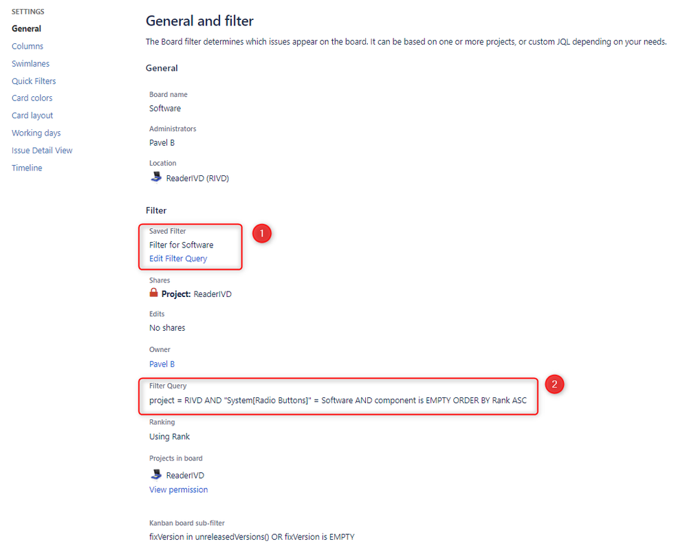

"Your issue XXXXXX has been created but is not currently visible because it does not match your board filter".
Maybe you can help me with this type of issue? I am able to create tasks and epics but they aren't visible. How can I create board filter to show all the tasks and epics?

While on the board, click on the 3 dots menu in the upper right.
Select Board Settings
In the General tab you should see the board filter. You should be able to click on that, update it and save it and then return to the board.
Jekaterina June 29, 2023
The first one or the second one?
I can't update the second one.
And what do I need to enter in the filter to show all the issues, f.e. in the timeline?

try to use the filter project = RIVD ORDER BY Rank ASC
Most likely it is the AND "System[Radio Buttons]" = Software that is causing the issue you are having. If this custom field is not being set on the create issue screen your board filter will not be able to display it and will display the error you are experiencing.
If you click Edit Filter Query in the first red box and remove this and save the filter and try to see if the issues are showing up.
It could potentially be the other part as well AND component is EMPTY if a component is automatically set on the issues created (or set on the create issue screen) you can try this as a second option.

John Funk
June 29, 2023
Yes, click on Edit Filter Query and make that change.

@Fredrik Dahl Hi, thank you for the answer. Maybe I have some other options because I need that AND "System[Radio Buttons]" = Software part.
Maybe there are some other options?

Fredrik Dahl
June 30, 2023
Yes, your option then is to make sure that the custom field System is present on the create issue screen - and also set (click the correct radio button) to Software
If System custom field is not set to Software on the create issue screen your issues will not show on the board.

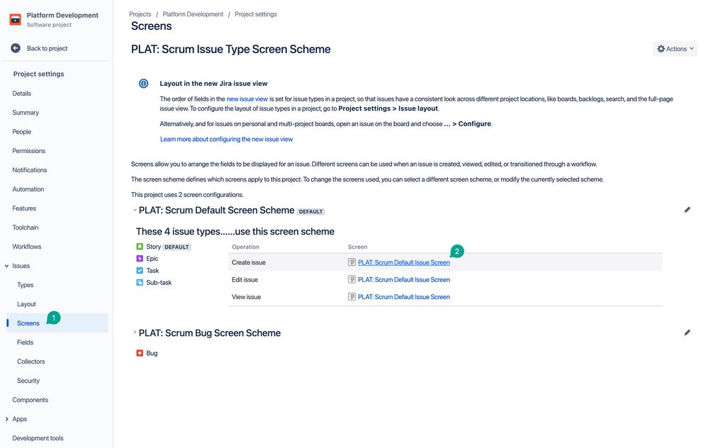

If you can post a screenshot of your create issue screen
Go to your project and click Project settings at the bottom in the left hand menu.
Then follow these steps: "1" click Issues/Screens and klick on "2" the create issue screen and take a screenshot of that

Jekaterina June 30, 2023
My screen looks like that:
System is present in the screen.
