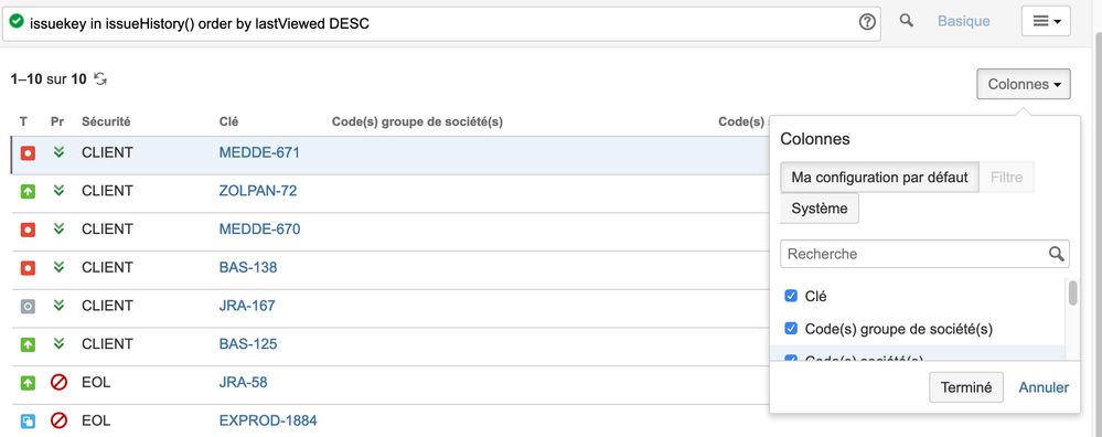

Whenever I am logging to the site and checking for issues, the page will not reflect the column changes that I have selected after applying it.

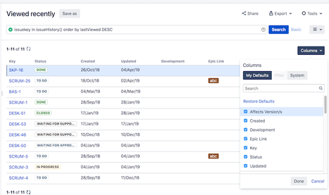

This is very strange to see.  It's almost as if you're browser isn't selecting the column view to use here.  In my instance, I can always see at least one view highlighted, but in your screenshot there are none.
