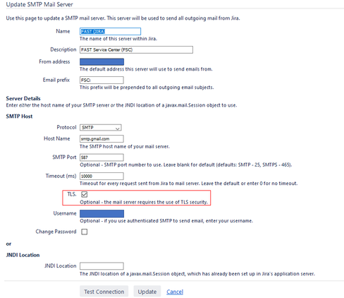

Have you enabled TLS/SSL (check True/Using)?
Try it for you.

The solution is correct configuration of the mail server, possibly on the email server side, but mostly you'll find there's something wrong on the Jira side.
With the TLS tick box enabled, please also try the protocol as "secure smtp".
If that does not help, then the I would want to be checking the logs while clicking "test" on the smtp settings.
