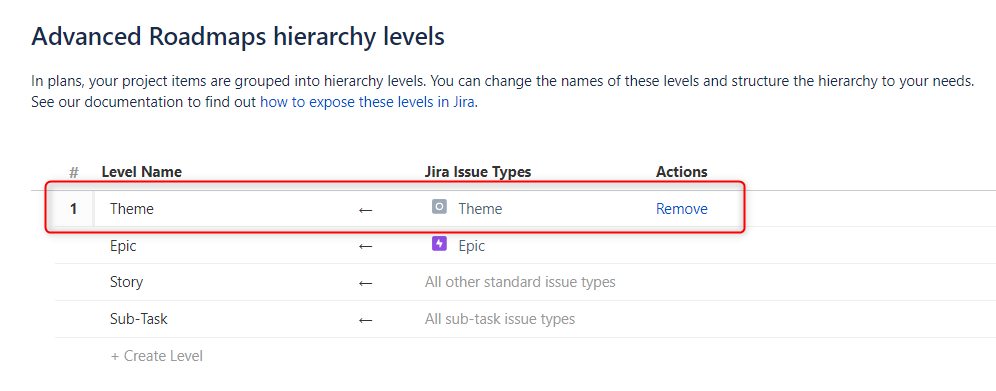

I have an issue to create a hierarchy level in a plan.
I followed the video: Configuring issue hierarchy above epics in Advanced Roadmaps - YouTube
But I have this issue and I am unable to create the new hierarchy level that I have configured:

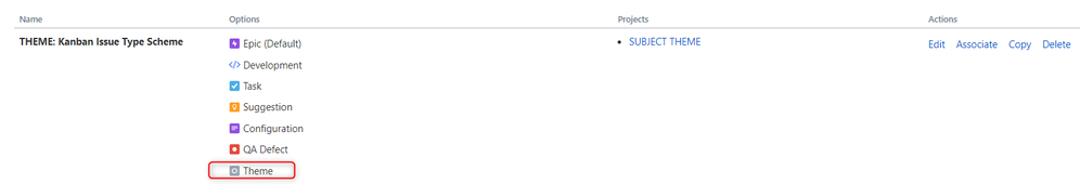

Here is, below,  the configuration I have done for my project. Am I missing something ? Thanks a lot for your help.
