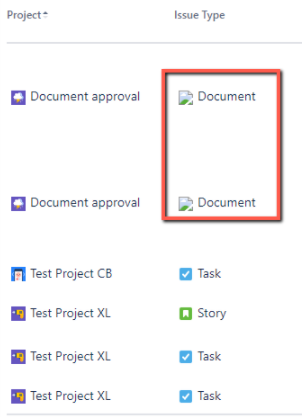

The icons of the "normal" issue types load successfully, but the icon of a "special" issue type does not load:
The strange thing is that the default issue type (Task) URL and the special issue type (Document) URL have the same format:
URL Task:
https://api.atlassian.com/ex/jira/4c02c84a-f03d-4c1d-9c7d-5576dad73da5/rest/api/2/universal_avatar/view/type/issuetype/avatar/10318?size=medium
URL Document:
https://api.atlassian.com/ex/jira/4c02c84a-f03d-4c1d-9c7d-5576dad73da5/rest/api/2/universal_avatar/view/type/issuetype/avatar/10557?size=medium
And as you can see in the image, the icon of the Task is loaded, but the icon of the Document is not loaded.

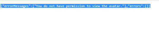

I did a GET to the URLs from the browser and the icon of the Task is loaded, but the GET of the Document shows me this error:
I don't know if the problem is due to the type of project, or what permissions are necessary for that type of issue (Document).
