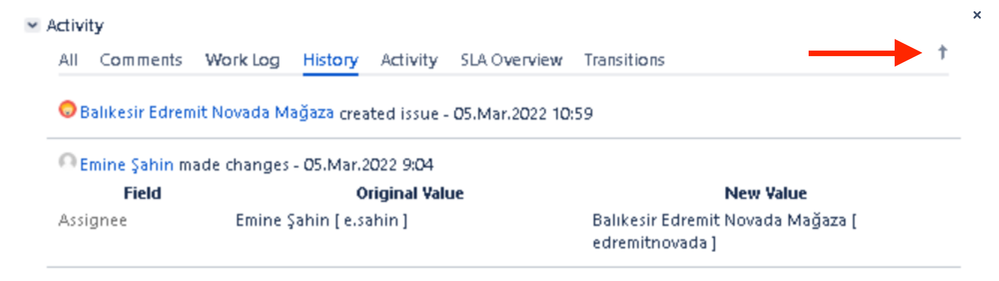

Hi there,
I have a problem. Issue update time appeared before created time like below
How can I solve this? Is there any solution for this problem?

They're talking about the timestamps.
Issue was created at 10:59
Issue was updated at 9:04

Typically time stamps include an indicator for the time of AM or PM. I have not seen a time format that did not include that. If the issue was created at 10:59 AM and updated at 9:04 PM then this order makes sense.
I think the next step is to review the time setting for the instance. That would need to be done by a Jira System Administrator.

serap_ileri August 4, 2022
Hi @Trudy Claspill , @padraik
There is nothing here where I can see the am/pm distinction. Is there such a method?
We can see the distinction if the problem with this log is related to it.

Administration -> System -> Look and Feel
"Date/Time Formats" section is at the very bottom.
serap_ileri August 7, 2022
Hi @padraik
Thanks so much, thats helped me :)
