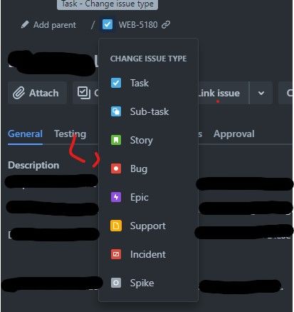

I am having an issue where I want to change the issue type for an issue.
It is no longer possible to change the issue type directly from the Icon when viewing an Issue. Specifically I want to change a Bug to a Task.
Interestingly, I am able to change a Task into a Bug (by selecting the Icon), but not the other way around.

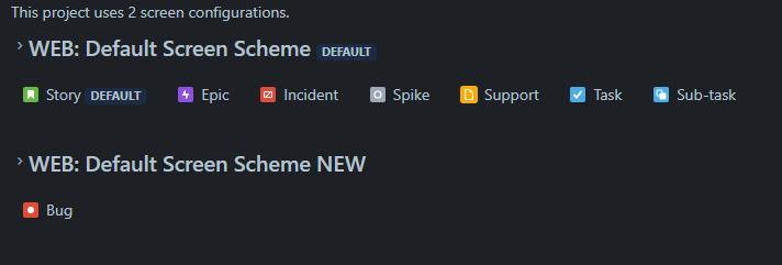

I also attached a picture of the existing Screens in case that might be useful information.

Have you checked that the "Issue Type" field is present on all screens (in this case, the one used by task, as Bug seems OK)?
Thanks that solved the first issue of not being able to change the issue type directly through the Icon!
