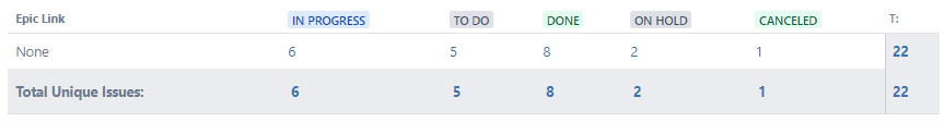

Hello All
I am trying to create a 2D Gadget in a Dashboard where i wanted to display Epic link  in YAxis and Status in XAxis like below
However when i saved i get the below result in which i do not see the Epic Data to the Left.
I tried to find Epic Summary which i couldnt find in the Drop Down as well.
All i want to see is the Epics on the Left side and the associated statuses.

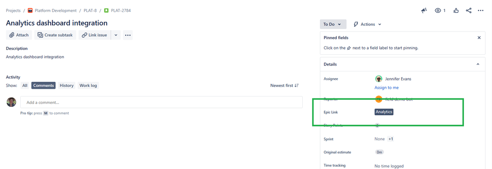

Valerie Knapp
November 2, 2023
Hi @Velagapudi, Srikanth , the Epic Link is the link to the Epic from other issues. In the Epic itself, it appears as the Epic Name, like this -
So, in this example, where I have the gadget displaying the Epic Link by Status, if I click on the number, for example, of 'In Progress', 'Cloud', I will get a report of the issues where they have the Epic Link of Cloud and the status of In Progress, not the list of Epics themselves. image.png
What is it that you want to achieve? A list of Epics? Please can you clarify?
Velagapudi, Srikanth November 2, 2023
@Valerie Knapp Thank you for your Quick reply
I want to see the Epic Link like you have on the Left side.I am getting None under Epic Link.When i checked the Epic issues they have the link like in your second picture
Below is mine

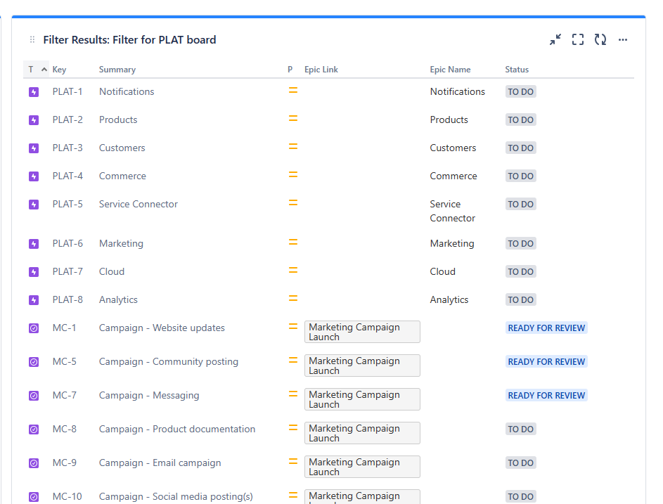

Valerie Knapp
November 2, 2023
Hi @Velagapudi, Srikanth , you will either be able to see the Epics with Epic Name or the child issues with Epic Link. The gadget isn't sophisticated enough to say, for example, if Epic Name is populated, show that, as opposed to the Epic Link.
You could try another gadget, like the Filter results to see everything together.image.png

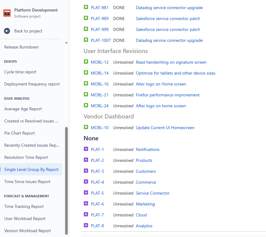

There is also a report inside of the project settings which might help you called the Single Level Group By Report. It works in a similar way to the gadget in that you choose a filter and then the variable you want to sort by to get something like this -
Otherwise, you can consider an app to extend the funtionality of the dashboard, but this is typically at a cost.
