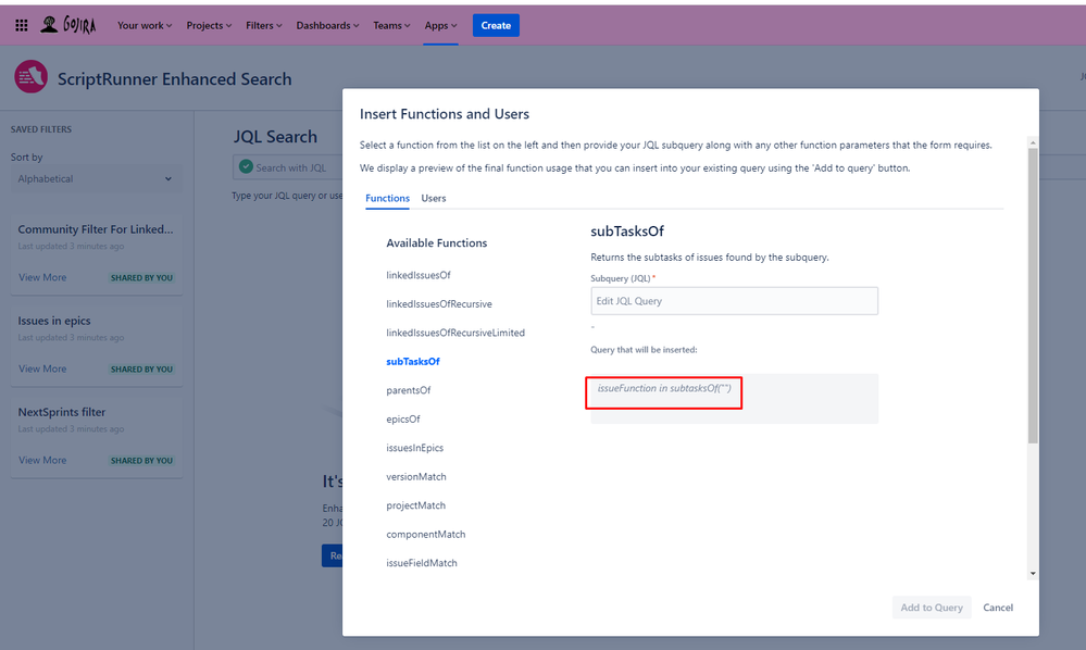

		@Tiago Pereira to reply to your answer:
But the "issueFunction" seems to not be present on the Syntax list.
The error produced on your post, clearly states a problem with "Epic Link", due to the missing AND/OR operator. This is one problem.
If you encounter a problem with issueFunction, is due to the fact that scriptrunner in cloud (and JQL) doesn't work like on the server. Scriptrunner cloud provide a different "search page", called enhanced search:

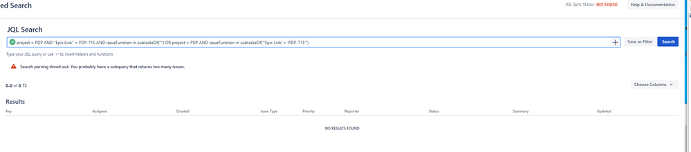

@Tiago Pereira to reply:
Hi Alex issue w/ Epic link is gone but now when trying to search w/ full JQL I get an parsing time out error, not sure how to solve this.
Also used the issue function option you showed seems to be correct I believe
ON your JQL use parenthesis to narrow down your results. In addition consider if you actually need the below statement, as it will return all subtasks:
issueFunction in subtaskOf("")
And one more advise would be to start adding jql statements bit-by-bit and see what is causing the problem.
