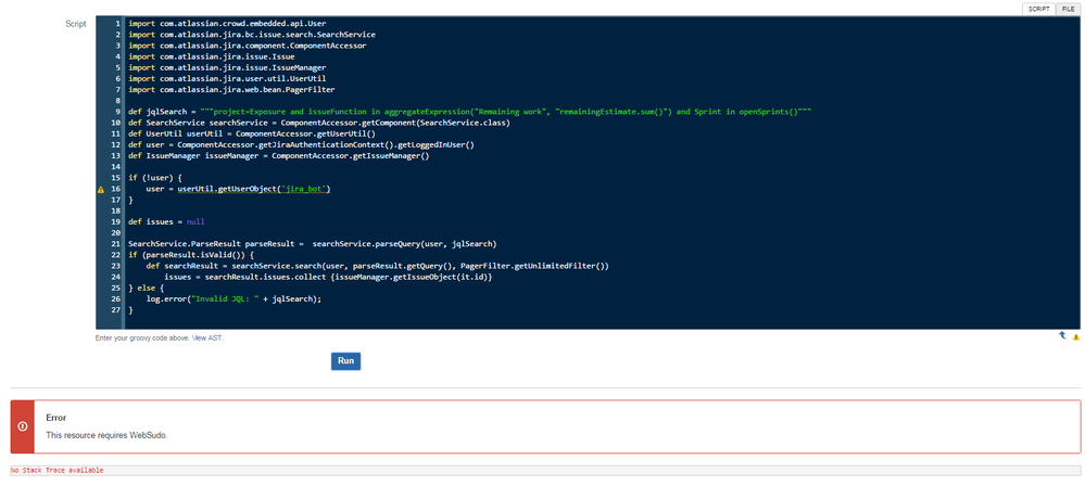

Requirement
From a script field to get the value and store in scripted custom field
Script:
Joshua Yamdogo @ Adaptavist
November 14, 2017
Your script looks correct from what I can tell. I believe the WebSudo error simply means your session has expired. You'll need to just log out of JIRA and log back in and try to run it again.
Josh
Alexey Matveev
November 14, 2017
Or you can just click Script Console and you will be able to get WebSudo back after providing your password.
November 14, 2017
@Alexey Matveev Good point :)
