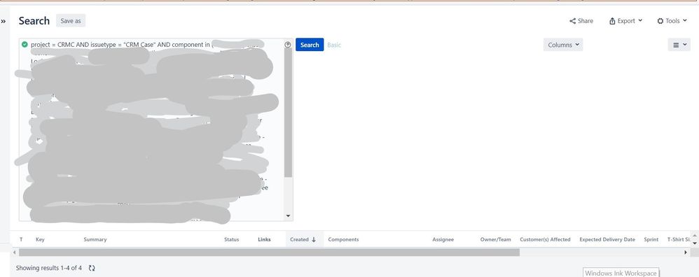

I do not see results unless I change the zoom factor of the browser to 50%. The JQL search box pretty much occupies all the space on the screen. There is no room left for results to be displayed
I'm sorry, that simply sounds like your screen is the wrong size, and the browser is being forced into trying to re-arrange things in a way that doesn't really work for you.
Could you give us a screenshot?

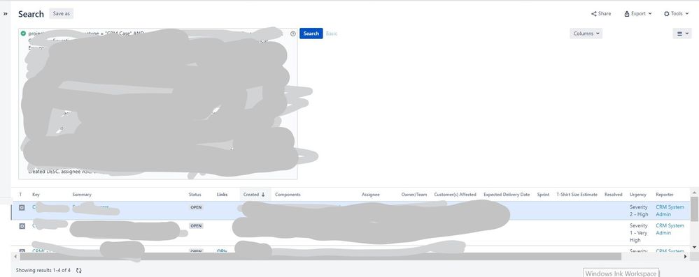

This used to work just fine before the upgrade. I have been using this query for past 6+ years. See attached the screenshot (screenshot-1). As you can see the JQL is long. and the screen is completely occupied by the JQL query textarea. Hope that explains. If I go into browser zoom size and reduce to 80%, the results start showing up (screenshot-3). If I reduce to 50%, I see full resultset (screenshot-4). I tried removing browser cache, restarted my machine but it hasn't helped.
Ah, ok, I see. It is the screen size I'm afraid.
Yes, your JQL length is causing a problem - the screen layout is built for the majority of cases where the JQL is a lot shorter and doesn't expand the box anywhere like as much, leaving more space on the screen for the results grid.
I'm afraid there is not a lot you can do about this. I would raise an improvement request with atlassian (start at https://support.atlassian.com/contact to get it routed correctly) - I think it's as simple as "please code for the search box to use the full width of the screen so it doesn't shove the results way down the page when you have a long JQL string"
