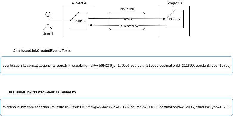

Bart_Joosten
January 17, 2020
Hi @Fernando Bordallo
Actions:
  1. User is working one issue-1
  2. In issue 1 the user is creating a issue-link to issue 2
Question:
  1. While listening on IssuelinkCreatedEvent how to get the "ID" or "Key" of issue 1
  2. While listening on IssuelinkCreatedEvent it is now not showing the inward or outward action that the user has selected while creating issuelink, for example "Tests" or "Is Tested by". How to get this value?
The current values that the event is given and where you can transform them into:
ID:                                       Current issue-link id that is counting up
SourceID:                        Issue object: Source issue
DestionationID:            Issue object: Destination issue
IssuelinkType:               The name of the issuelink: Test
I want to know the issue object that the user is calling the IssuelinkCreatedEvent on or the issuelinktype that he is using, at this moment the event does not supply this information. because i only want to allow specific types of links on issue 1 i need to know the type of the link he is creating or on which ticket he is creating the issuelink on.
Because the DestionationID and SourceID are different on the type of link you have selected i can never tell my scriptrunner script what is the main issue he needs to check the links on.
So i think the event is missing a parameter of the current issuekey or the issuelinkType parameter is to global and is giving only back the name and should be giving back the type inward or outward! for example 2 events that should solve the problem whit if they would provide one of the following parameters:
Current event is giving back:
eventissuelink:com.atlassian.jira.issue.link.IssueLinkImpl@456f4236[id=170506,sourceId=212096,destinationId=211890,issueLinkType=10700]
Should be one of the following:
eventissuelink:com.atlassian.jira.issue.link.IssueLinkImpl@456f4236[id=170506,sourceId=212096,destinationId=211890,issueLinkType=10700,issuelinkDescription=[Tests] Or [IsTestedby]]
eventissuelink:com.atlassian.jira.issue.link.IssueLinkImpl@456f4236[id=170506,sourceId=212096,destinationId=211890,issueLinkType=10700,ExecutionIssue=[Issue1]]
Bart_Joosten
January 17, 2020
Actions:
Question:
Current event:
Solving event 1:
Solving event 2:
