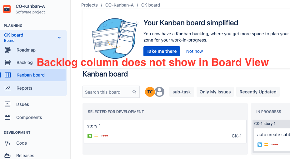

Are you working with a Team Managed project or a Company Managed project? It will say at the bottom of the navigation pane on the left.

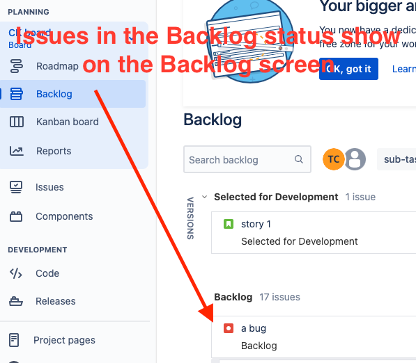

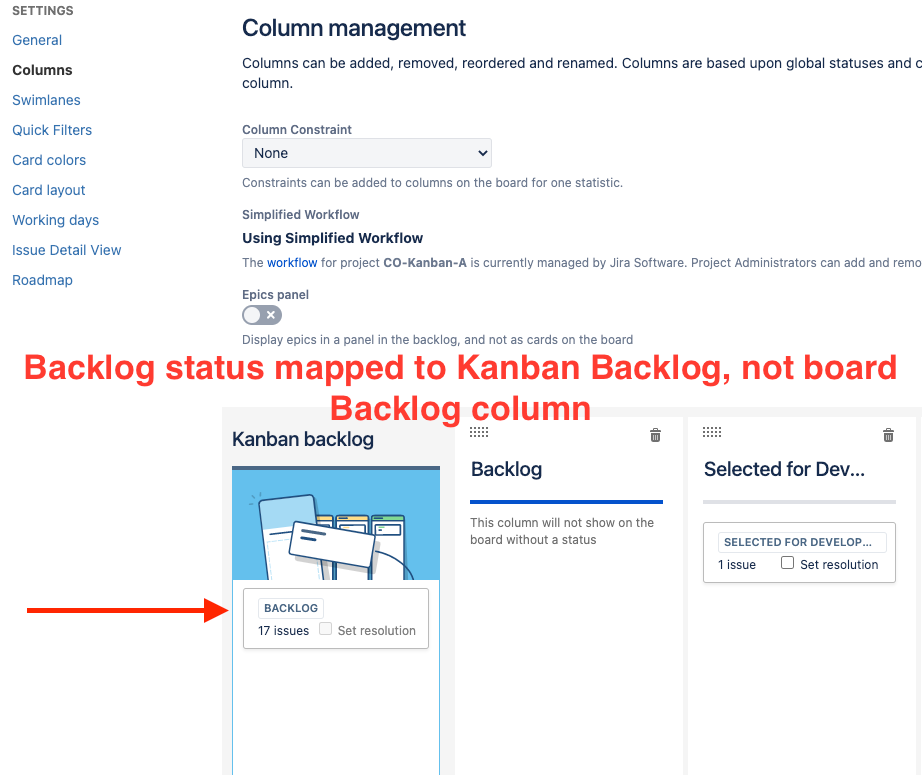

With a Company Managed project Kanban board that has the Backlog feature enabled, you map a Status to the Backlog "column". Any issue in this status will show on the Backlog screen rather than in the board view.
In the below screen I show the Board Settings > Columns where I have mapped the Backlog status to the "Kanban Backlog" section. That will make issues in that status show on the Backlog Screen rather than on the Board, as shown in the second and third images.
If you have no Statuses mapped to the Kanban Backlog, then there will be no Backlog screen and issues in all statuses are shown on the Board view.
If you are using a Team Managed Kanban board, then the Backlog screen does show all issues of all statuses divided into two sections; Backlog and Board. The Board section of the Backlog screen shows all the issues on the Board. The Backlog sections shows all the issues that you have not yet moved to the board. Neither of these sections is based on Status. An issue in any Status can be in either the Backlog or the Board.

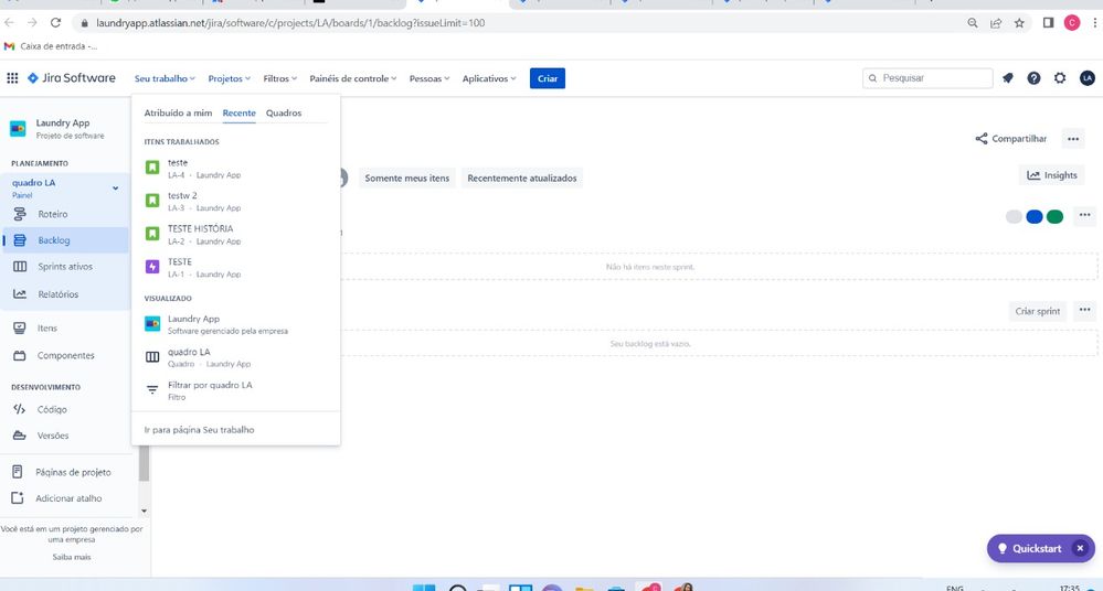

I'm having the same difficulty, but on the Scrum board, it doesn't provide the Backlog feature. I'm not able to make the created items go to the backlog. Can you help me? @Trudy Claspill

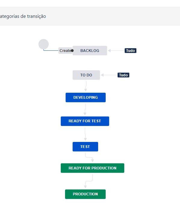

É um projeto gerenciado pela empresa.

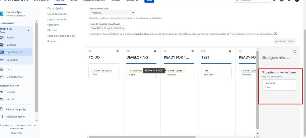

Quando ADD o status backlog no quadro eles aparecem, mas ai tbm aparece no quadro.
Se você tiver um status na seção Status não mapeados, os problemas nesse status não serão exibidos na tela Backlog ou na tela Board. Você precisa mapear o Status para uma coluna.
Com os quadros do Scrum, os problemas não são colocados no Backlog com base em seu status. Os problemas na seção Backlog da tela Backlog podem estar em qualquer status. A tela Backlog serve para organizar seus problemas por prioridade e colocá-los em Sprints.
O que determina se os problemas são exibidos na tela do quadro é se eles forem adicionados a um Sprint ativo (iniciado).
Quando você olha para a tela Backlog, os problemas na seção Backlog da lista e os problemas nas seções Sprint para sprints que não foram iniciados não serão exibidos na tela Board. O Status do problema não afeta a tela em que o problema é exibido.

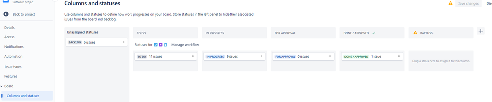

I'm using the statuses as below.
Since it is the same name I expected that any issue in the status Backlog automatically shows up under the igation Backlog. This is not the case as you describe.
Column Management does look different in my version. There is possibility to reeelate a status to Backlog.

Hello @Karl Bornscheuer
Regarding the three points at the end of your post, yes, you understood the first one correctly. When the Create button is used from the menu bar, the issue will automatically be added to the Backlog of the Team Managed Kanban board (when Backlog is enabled) and you cannot change that behavior.

Sorry for the very late reply. Yes, you can have a Status named "Backlog" in a Team Managed project, but that does not have any explicit tie to the "Backlog" section of the Backlog screen. They are two separate things.
