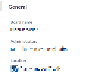

In the project -> board settings -> general
There I changed the "location" in something else and now everything is back.

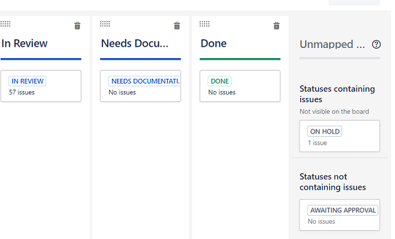

Have you checked the Columns under Board settings? Look if there are any unmapped statuses on the very right.

Thank you for your reply. Yes there are unmapped statuses but they don't contain issues.

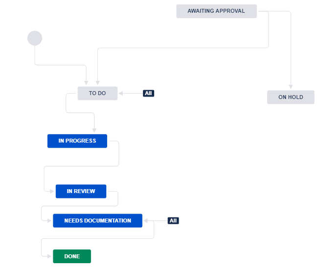

Here is the workflow, it's used by all other projects and they don't have the problem of disappearing issues
