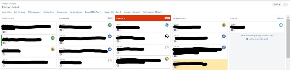

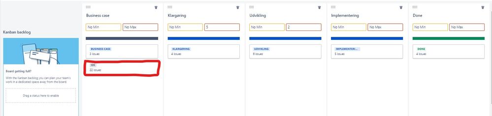

Picture 1. When the backlog-status is set to be shown in first column of the board, all issues across all columns are on the board

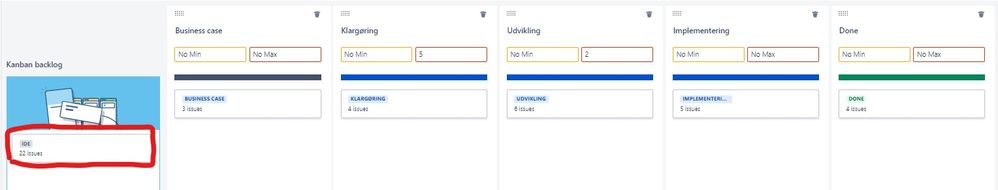

Picture 2. When the backlog-status is set to be shown in backlog, no issues are shown in any column or backlog
Picture 1
"Ide" status in first column = all issues seen on the board, including the ones with status = "Ide".
The same can be accomplished by removing "Ide" status altogether from the board. In this case the issues with status = "Ide" is not visible on the board (as expected).
Picture 2
"Ide" status in backlog = no issues on the board or backlog

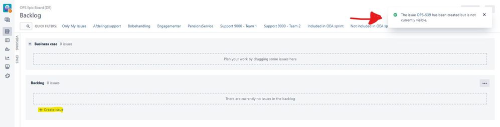

Even if I test it, by creating an epic directly in the backlog, it does not show (see below screenshot).
For reference, one of my other epic boards, set up in the exact same way, does show everything as expected.

Below images maybe show the issue more clearly:
Picture 1. When "Ide" status is set to be shown in first column of the board, all issues across all columns are on the board
Picture 2. When "Ide" status is set to be shown in backlog, no issues are shown in any column or backlog
Picture 1
"Ide" status in first column = all issues seen on the board.
Picture 2
