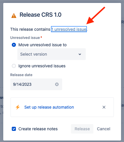

When you execute the Release action it will give you a pop-up with a link to display all the unresolved issues. You may want to click that link to confirm which issues Jira is considering resolved vs. unresolved.
