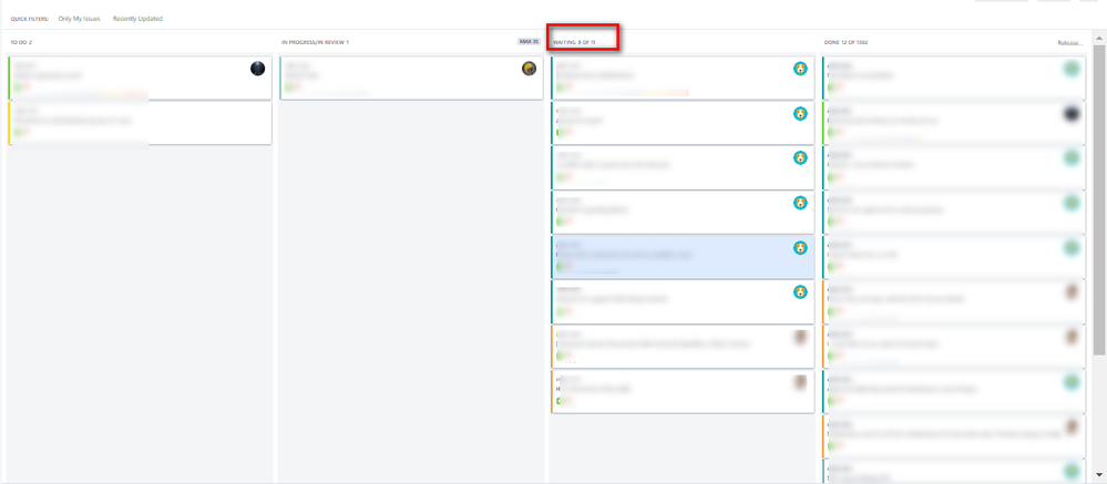

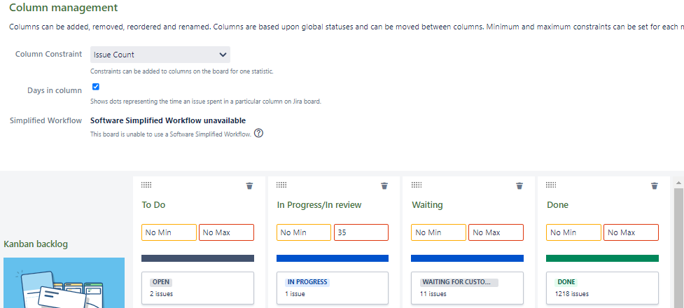

Hello Community!
Could you help me understand how is it possible that some issues that are not updated longer than 2 weeks are no longer shown on Kanban Board. I can even see in the colum heading "WAITING 8 OF 11", so 3 issues are not shown.
I have noticed that it happens to status "Waiting for Customer" (status category "To do"), status is not used in last column and the resolution of issues is "Unresolved".
We do use functionality to hide completed issues older than 1 week. But I guess this should work for issues in last column only.
I will grately appreciate your help!
Kind Regards.

Can you show us the filter used for the board?
Also check Board Settings > General, at the bottom of the page for any sub-filter to see if that is causing the issues to be hidden.

Hi @Anna Bartczak
Your image of the board is truncated.  Would you please show the entire image to show if any of the quick filters or people/assignees are selected?  Selecting a quick filter or assignee would definitely hide some issues.

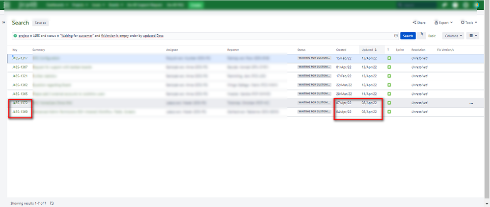

Also, have you tried to use advanced search to view the issues which are not displaying to see if there is something different about them?  For example, perhaps someone has actually assigned a version.
You could view just the issues in that board column with this JQL and then find the ones not shown on the board by comparison:
project = J4BS AND status = "Waiting for Customer" ORDER BY Rank ASC

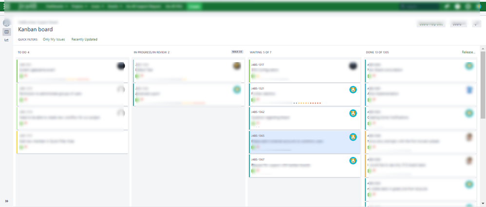

Anna Bartczak April 15, 2022
Hello @Bill Sheboy
There is no quick filter selected and no swimlanes applied. Below I am attaching again print screen of the board and the results of the JQL.
The last two issues form the JQL query are not visible on the board and they were updated last time one week ago (today is 15.04.22 and they were last updated 08.04.22). That is the only logic I can see... It seems like "hide completed issues older than": 1 week is affecting this column - which is not the last "Done" column :(.
