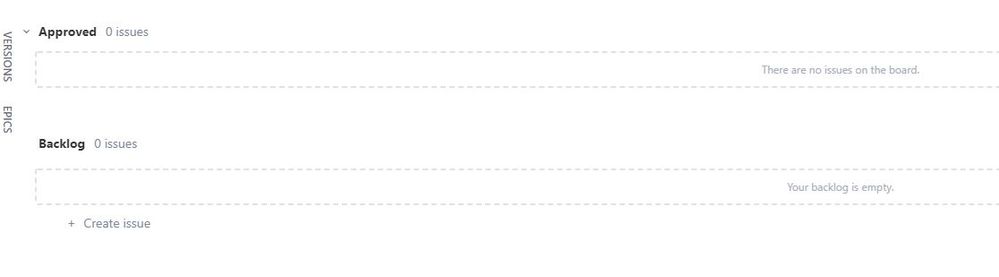

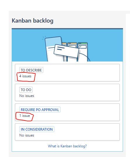

×As you can see, I have two statuses in the "Kanban backlog" column.
But in the backlog, I don't see anything. (I do not have any quick filters on & according to the "permission helper", I can see the five issues here.
When I create an issue, from the header, I get to see the following message:
Any ideas anyone?
Help?
Hi Mick - Check your Board filter and sub-filter to see what it is actually letting through. When cards are created, they will flash the message you see and then end up in the first status in your Workflow. That's usually Backlog. But check your workflow for sure - yours might be the To Describe status.
From board settings:
If I open the filter query and add in the sub-filter query, the issues do not appear anymore.
Opening the "fix versions" column, does only show an empty field.
Can I just delete this sub-filter?
Looking at it again.. "fix versions" column exist, fixVersion does not exist.
But writing in the query, it is fixVersions.
For now I have deleted the sub-filter [fixVersion in unreleasedVersions() OR fixVersion is EMPTY]
If I should not! Please let me know. Otherwise, the issue seems fixed.
Thank you for your guidance.
Have you checked if there aren't any filters currently active? A quick filter e.g or an epic or version that has been selected?
No version-, epic- or quick filters area active.
As John is suggesting, could you check what the status of your issues is immediately after they are created?
In the example you shared (CRF-6) - what was the issue status when it was just created?
The status became "to describe", as expected.
I've created my own workflow for this.
The issue seemed to be the kanban board sub-filter. I don't understand why this default field broke my board, but deleting it fixed it.
Thanks for your help anyways!
