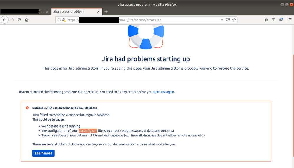

Now i've put Jira into upgrade mod, stop jira with "systemctl stop jira", decompressed the *.tar.gz to our "/opt/jira" location and reconfigured the "server.xml", "setenv.sh", "jira-application.properties", "seraph-config.xml" and our sso plugin. The dbconfig.xml is unchanged.
After all that I started JIRA with "systemctl start jira" and opened the URL. I Only got the following error:

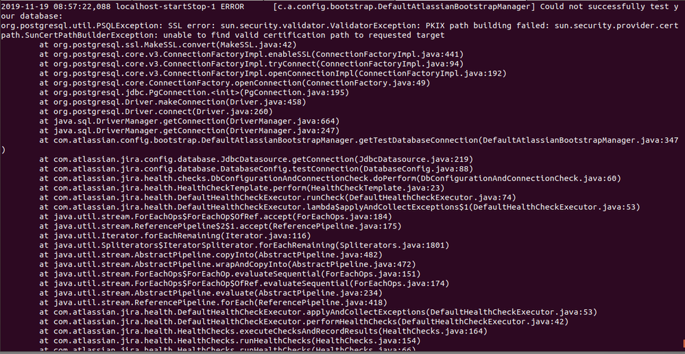

The "/var/jira/log/atlassian-jira.log" is giving me this:

2019-11-20 10:16:15,844 localhost-startStop-1 ERROR [c.a.config.bootstrap.DefaultAtlassianBootstrapManager] Could not successfully test your database:
org.postgresql.util.PSQLException: Could not open SSL root certificate file /home/jira/.postgresql/root.crt.
at org.postgresql.ssl.LibPQFactory.<init>(LibPQFactory.java:120)
at org.postgresql.core.SocketFactoryFactory.getSslSocketFactory(SocketFactoryFactory.java:61)
at org.postgresql.ssl.MakeSSL.convert(MakeSSL.java:33)
at org.postgresql.core.v3.ConnectionFactoryImpl.enableSSL(ConnectionFactoryImpl.java:441)
at org.postgresql.core.v3.ConnectionFactoryImpl.tryConnect(ConnectionFactoryImpl.java:94)
at org.postgresql.core.v3.ConnectionFactoryImpl.openConnectionImpl(ConnectionFactoryImpl.java:192)
at org.postgresql.core.ConnectionFactory.openConnection(ConnectionFactory.java:49)
at org.postgresql.jdbc.PgConnection.<init>(PgConnection.java:195)
at org.postgresql.Driver.makeConnection(Driver.java:458)
at org.postgresql.Driver.connect(Driver.java:260)
at java.sql.DriverManager.getConnection(DriverManager.java:664)
at java.sql.DriverManager.getConnection(DriverManager.java:247)
at com.atlassian.config.bootstrap.DefaultAtlassianBootstrapManager.getTestDatabaseConnection(DefaultAtlassianBootstrapManager.java:347)
at com.atlassian.jira.config.database.JdbcDatasource.getConnection(JdbcDatasource.java:219)
at com.atlassian.jira.config.database.DatabaseConfig.testConnection(DatabaseConfig.java:88)
at com.atlassian.jira.health.checks.DbConfigurationAndConnectionCheck.doPerform(DbConfigurationAndConnectionCheck.java:60)
at com.atlassian.jira.health.HealthCheckTemplate.perform(HealthCheckTemplate.java:23)
at com.atlassian.jira.health.DefaultHealthCheckExecutor.runCheck(DefaultHealthCheckExecutor.java:74)
at com.atlassian.jira.health.DefaultHealthCheckExecutor.lambda$applyAndCollectExceptions$1(DefaultHealthCheckExecutor.java:53)
at java.util.stream.ForEachOps$ForEachOp$OfRef.accept(ForEachOps.java:184)
at java.util.stream.ReferencePipeline$2$1.accept(ReferencePipeline.java:175)
at java.util.Iterator.forEachRemaining(Iterator.java:116)
at java.util.Spliterators$IteratorSpliterator.forEachRemaining(Spliterators.java:1801)
at java.util.stream.AbstractPipeline.copyInto(AbstractPipeline.java:482)
at java.util.stream.AbstractPipeline.wrapAndCopyInto(AbstractPipeline.java:472)
at java.util.stream.ForEachOps$ForEachOp.evaluateSequential(ForEachOps.java:151)
at java.util.stream.ForEachOps$ForEachOp$OfRef.evaluateSequential(ForEachOps.java:174)
at java.util.stream.AbstractPipeline.evaluate(AbstractPipeline.java:234)
at java.util.stream.ReferencePipeline.forEach(ReferencePipeline.java:418)
at com.atlassian.jira.health.DefaultHealthCheckExecutor.applyAndCollectExceptions(DefaultHealthCheckExecutor.java:53)
at com.atlassian.jira.health.DefaultHealthCheckExecutor.performHealthChecks(DefaultHealthCheckExecutor.java:42)
at com.atlassian.jira.health.HealthChecks.executeChecksAndRecordResults(HealthChecks.java:164)
at com.atlassian.jira.health.HealthChecks.runHealthChecks(HealthChecks.java:154)
at com.atlassian.jira.health.HealthChecks.runHealthChecks(HealthChecks.java:66)
at com.atlassian.jira.startup.BootstrapContainerLauncher.start(BootstrapContainerLauncher.java:48)
at com.atlassian.jira.startup.DefaultJiraLauncher.preDbLaunch(DefaultJiraLauncher.java:117)
at com.atlassian.jira.startup.DefaultJiraLauncher.lambda$start$0(DefaultJiraLauncher.java:103)
at com.atlassian.jira.util.devspeed.JiraDevSpeedTimer.run(JiraDevSpeedTimer.java:31)
at com.atlassian.jira.startup.DefaultJiraLauncher.start(DefaultJiraLauncher.java:102)
at com.atlassian.jira.startup.LauncherContextListener.initSlowStuff(LauncherContextListener.java:154)
at com.atlassian.jira.startup.LauncherContextListener.initSlowStuffInBackground(LauncherContextListener.java:139)
at com.atlassian.jira.startup.LauncherContextListener.contextInitialized(LauncherContextListener.java:101)
... 5 filtered
at java.util.concurrent.FutureTask.run(FutureTask.java:266)
at java.util.concurrent.ThreadPoolExecutor.runWorker(ThreadPoolExecutor.java:1149)
at java.util.concurrent.ThreadPoolExecutor$Worker.run(ThreadPoolExecutor.java:624)
at java.lang.Thread.run(Thread.java:748)
Caused by: java.io.FileNotFoundException: /home/jira/.postgresql/root.crt (No such file or directory)
at java.io.FileInputStream.open0(Native Method)
at java.io.FileInputStream.open(FileInputStream.java:195)
at java.io.FileInputStream.<init>(FileInputStream.java:138)
at java.io.FileInputStream.<init>(FileInputStream.java:93)
at org.postgresql.ssl.LibPQFactory.<init>(LibPQFactory.java:117)
2019-11-20 10:16:15,887 localhost-startStop-1 ERROR [c.a.jira.health.HealthChecks] JIRA couldn't connect to your database
2019-11-20 10:16:15,887 localhost-startStop-1 ERROR [c.a.jira.health.HealthChecks] JIRA failed to establish a connection to your database.
This could be because:
- Your database isn't running
- The configuration of your dbconfig.xml file is incorrect (user, password, or database URL etc.)
- There is a network issue between JIRA and your database (e.g. firewall, database doesn't allow remote access etc.)
There are several other solutions you can try, review our documentation and see what works for you.
2019-11-20 10:16:15,891 localhost-startStop-1 INFO [c.a.jira.startup.JiraStartupLogger] Running JIRA startup checks.
2019-11-20 10:16:15,892 localhost-startStop-1 FATAL [c.a.jira.startup.JiraStartupLogger] Startup check failed. JIRA will be locked.
2019-11-20 10:16:15,966 localhost-startStop-1 INFO [c.a.jira.startup.LauncherContextListener] Memory Usage:
Heap memory : Used: 138 MiB. Committed: 3926 MiB. Max: 3926 MiB
Non-heap memory : Used: 39 MiB. Committed: 62 MiB. Max: 1536 MiB
TOTAL : Used: 177 MiB. Committed: 3987 MiB. Max: 5462 MiB
This is our "dbconfig.xml"
<?xml version="1.0" encoding="UTF-8"?>
<jira-database-config>
<name>defaultDS</name>
<delegator-name>default</delegator-name>
<database-type>postgres72</database-type>
<schema-name>public</schema-name>
<jdbc-datasource>
<url>jdbc:postgresql://database.de:5432/jira_db?ssl=true</url>
<driver-class>org.postgresql.Driver</driver-class>
<username>jira</username>
<password>password</password>
<pool-min-size>20</pool-min-size>
<pool-max-size>20</pool-max-size>
<pool-max-wait>30000</pool-max-wait>
<validation-query>select 1</validation-query>
<min-evictable-idle-time-millis>60000</min-evictable-idle-time-millis>
<time-between-eviction-runs-millis>300000</time-between-eviction-runs-millis>
<pool-max-idle>20</pool-max-idle>
<pool-remove-abandoned>true</pool-remove-abandoned>
<pool-remove-abandoned-timeout>300</pool-remove-abandoned-timeout>
<pool-test-on-borrow>false</pool-test-on-borrow>
<pool-test-while-idle>true</pool-test-while-idle>
</jdbc-datasource>
</jira-database-config>
Why is the there now a "org.postgresql.util.PSQLException" and how can i solve this issue?
Petr Vaníček
November 20, 2019
for you is important this line
So probably there is no certificate or Jira user doesn't have access to this file.
Joshua Kuchenbäcker November 20, 2019
Hello Petr,
yes, this file don't exist, but this wasn't a problem before the update. As a workaround i've tried this:
sudo -s
cp /root/cert.crt /home/jira/.postgresql/root.crt
chown jira:jira /home/jira/.postgresql/root.crt
Now i have this error:
I don't understand what is changed in 8.5.1 that i can't connect to the database anymore.
Petr Vaníček
November 20, 2019
So you are using probably self-signed cert. If it's your case then you need import cert into keystore.
Do you need SSL for DB connection (like it's not in same network)?
Vickey Palzor Lepcha
November 20, 2019
So your Database is enabled to accept SSL connections right ?
The certificate is imported to the system keystore and java keystore.
And yes, the system worked until the update and I changed nothing in the configurations.
