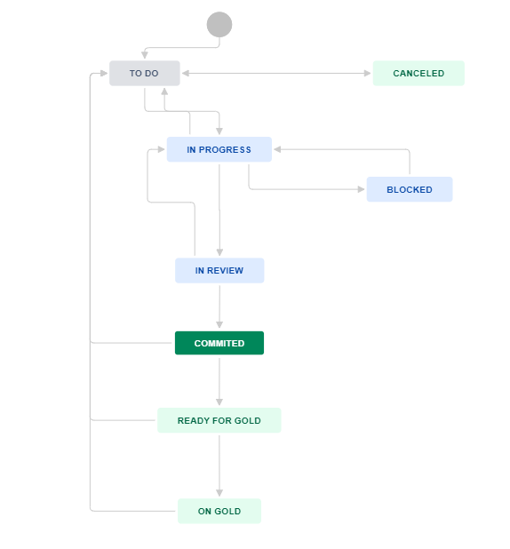

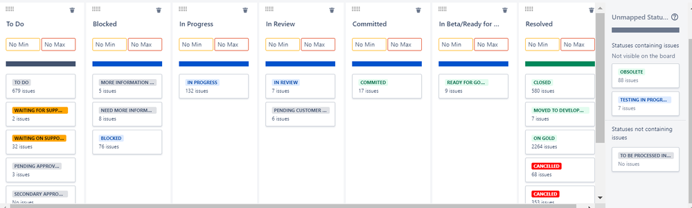

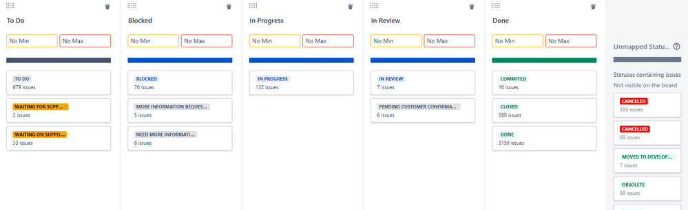

Thank you! I think I know what might be the issue. I have the same configuration as you suggested, except, my full flow board is also a scrum board and not a kanban one. Could that be the problem?
Here is the configuration as well, if you could take a look and tell me if anything looks off.
The workflow I'm having issue with:
Sprint board:
Full flow board:Screenshot 2022-03-20 124252.png

From my testing - it's confusing having two Scrum boards
  • On the limited board, Issues didn't reappear in the Backlog after the Sprint but...
  • The Sprint Reports listed them as incomplete, even though they were in the last column
^ This is incorrect behaviour.
You might find though this isn't exactly how your boards behave either, as it depends on the full setup.
Boards are just a visualisation of a filter - and don't own closure, statuses, sprints, etc. You might even find sprints which appear on both boards, etc. It's an abnormal setup from a Jira perspective.
So I would recommend...
  • Have a Scrum Board for the limited board - issues go into one Scrum Board only
  • Have a Kanban Board for the full flow
Ste
