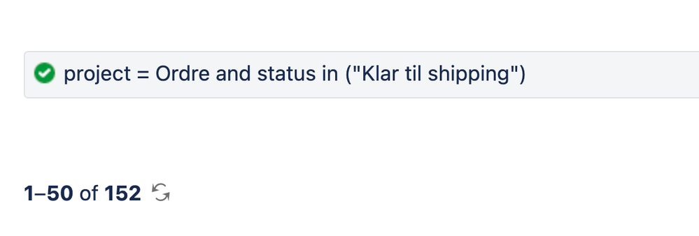

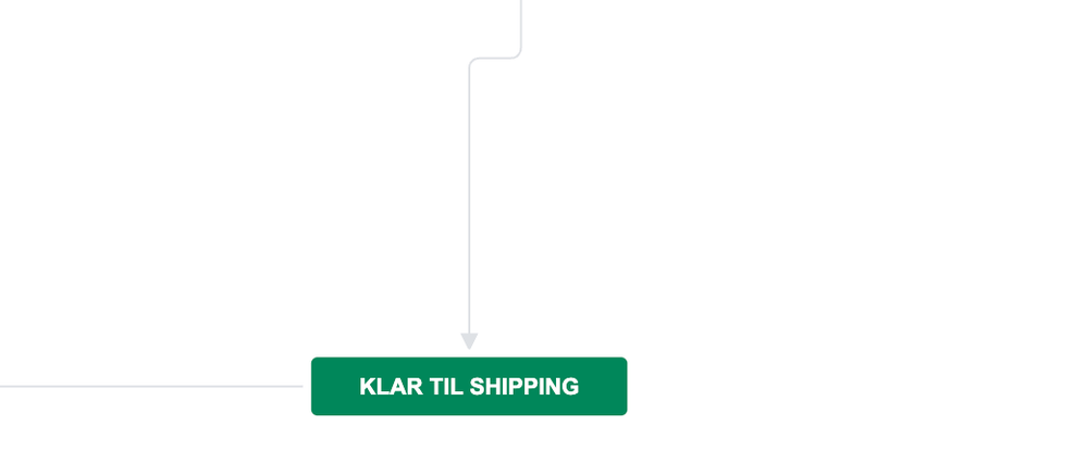

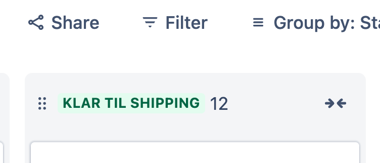

I have some issues (not all) has gone missing from my board and more i can not search them using board search but i can them find using the more general search in the top right of the screen and the advanced issue search.
My issues are missing from a status called "Klar til shipping". An issue has a summary like SOxxxxxx SQxxxxxx ROxxxxxx abd this is normally what i would search on using the board search. I understand why search comes up empty as the specific issue is not found in the "Klar til shipping" column on the board.
This problem appeared the first time i January where i bulk moved all issues bank and forth in the workflow and they all became visible in the "Klar til shipping" board column. At some time during the past week 140 issues out of 152 is now again not searchable in the board and they are all in status  "Klar til shipping".
I have checked my workflows, they have not changed.
-Part of workflow with status name.
-Board count
-Search count

Hi @JensH  - That's because the KLAR TIL SHIPPING status is a Done category of statuses. Issues with a status of a Done category will disappear from a Jira Work Management board 2 weeks after moving into that status.
