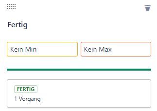

when i edit the columns to assign the status it says for done "1 process".
this is the process i am missing.

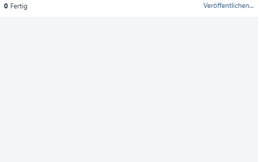

the summary board is kanban, in the attached files you should see what i mean
and the column is empty
David Müller August 12, 2018
solved!
had to edit the sub-filter for the "summary" board from
fixVersion in unreleasedVersions() OR fixVersion is EMPTY
to
fixVersion in unreleasedVersions() OR fixVersion is EMPTY OR fixVersion in releasedVersions()
thanks for your help!
