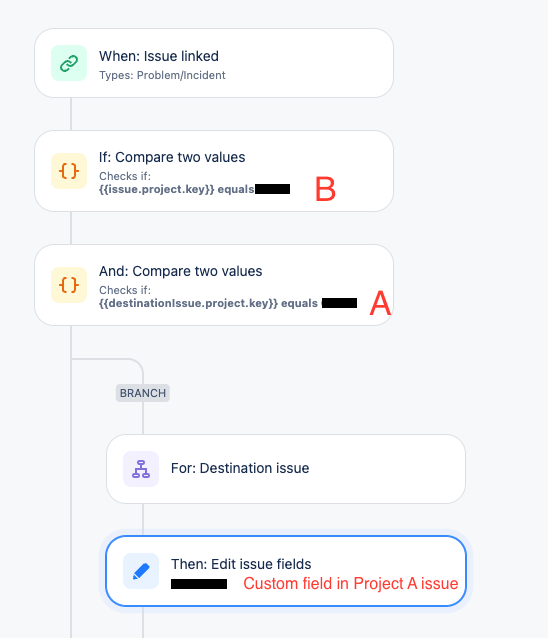

Here is the rule:

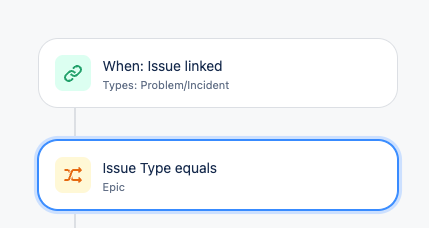

In my instance "Problem/Incident" is the name of the link type that provides the "causes"/"is caused by" relationship.
When you use the Link Issues trigger, that is a special case where the rule is actually triggered by the issue that shows the Outward Description part of the link relationship. So, regardless of whether you create the link from the Project A issue or the Project B issue, the rule is triggered by the issue that shows it "causes" the other issue. In the below screen image issue CS-85 displays that it "causes" CMSB-11, so it is CS-85 that is the issue triggering this rule.
With the Link Issue trigger the rule has a special option to recognize one of the issues as the "source" issue, and one as the "destination" issue. The one that is the "source" is the one that triggered the rule. The issue to which it has been linked is the "destination" and can be referenced with the special smart value {{destinationIssue}}
The conditions after the trigger ensure that the rule will continue to process only when it is triggered by a link being created from an issue in Project B to an issue in Project A. This is necessary because the Rule Scope must name both projects. Without these conditions the rule could execute when an issue in Project A was linked as "causes" an issue in Project B.

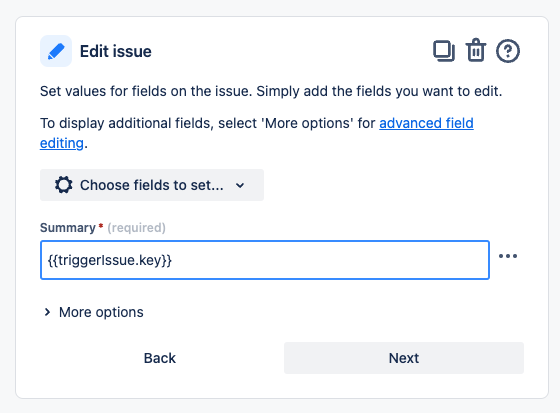

You want to update the issue in Project A, but with this rule it is the issue that is in Project B that triggered the rule. So you need to use a For Branch component to change the focus to the issue in Project A. Because the Link Issue trigger is used, we can use a special option in the For Branch to specify changing the focus to the "destination" issue in the linked pair.
And then, lastly, you use an Edit action to edit your custom field in Project A to add the value from the source issue (Project B). Because the source issue is the one that triggered the rule you can use the smart value {{triggerIssue}} to reference that issue. I used the Summary field in my example.

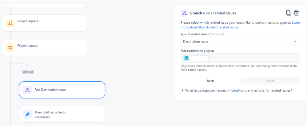

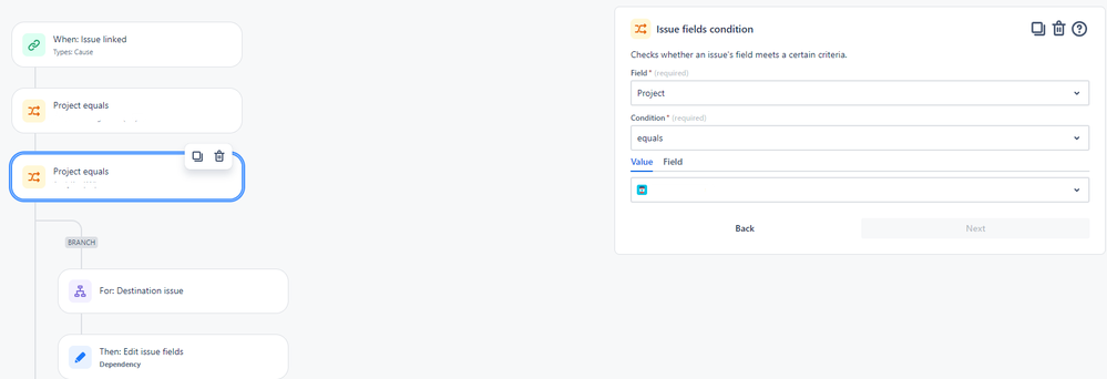

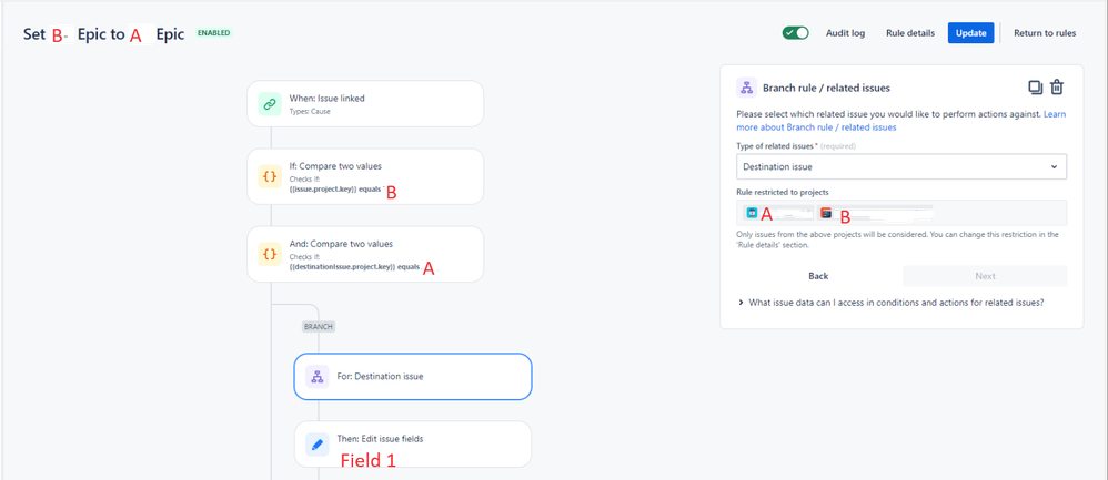

Parag Ahire March 14, 2024 edited
Hello @Trudy Claspill - these are the steps I followed. I did not get the expected result.
Rule layout (project names erased - first Project-B and second Project-A)
When block
Project Equals (1st - Project-B)
Project Equals (2nd - Project-A)
For block
Then block (field is Dependency and is chosen)
Tests :
1) While in Issue-1 of Project-B, create a causes link to Issue-2 in Project-A
Expectation : Dependency Field in Issue-2 of Project-A is set to Issue-1
Result : Dependency Field in Issue-2 of Project-A is blank
2) While in Issue-2 of Project A, create a caused by link to Issue-1 in Project-B

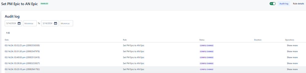

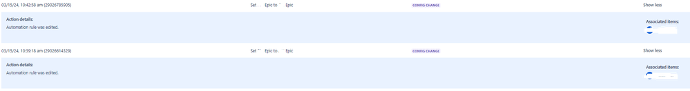

@Trudy Claspill - You might ask for the audit log. So, here is the image. Rule did not trigger.
Trudy Claspill
March 14, 2024
Sometimes there is a delay in the updating of the Audit Log screen. Please check it again to see if logs have shown up.

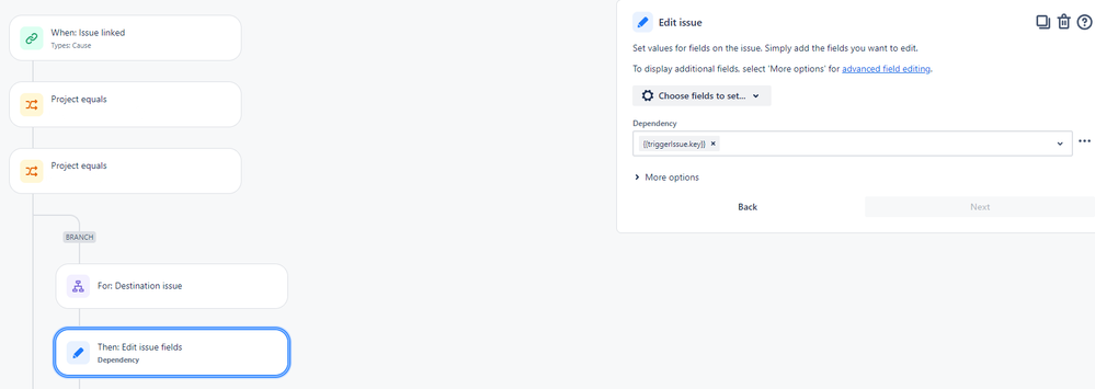

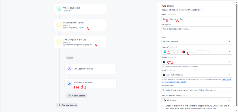

Parag Ahire March 18, 2024 edited
Hello @Trudy Claspill  Here are some screen images as requested. The rule hasn't triggered as per the audit log.
Note:
i) Project names, user names have been intentionally erased.
ii) The JIRA admin created the rule by entering Project Settings / Automation of Project A.
iii) Third screen below shows that the scope is limited to Project A even though the rule was created by JIRA Administrator. Is that a cause of an issue ?

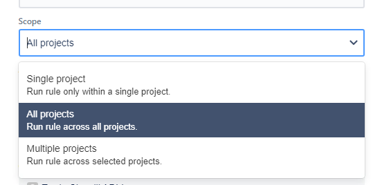

Trudy Claspill
March 18, 2024
The third screen indicates the rule was not set up as a multiple-project scoped rule. And yes, that is the reason the rule is not being triggered.
To create a multiple-project scoped rule the Jira Administrator must navigate to the Global Automation screen.
https://yourBaseUrl/secure/AutomationGlobalAdminAction!default.jspa#/
When creating the rule there the administrator will need to change the Scope field to "Multiple projects".
The administrator will then need to specify your A and B projects in the "Restrict to projects" field.

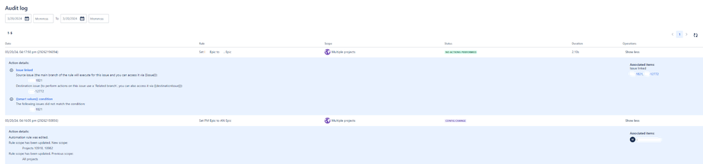

Parag Ahire March 20, 2024
Thanks @Trudy Claspill . I think we are close to get this to work.  This is the audit log.Step 15.png
What are we missing ?
Trudy Claspill
March 20, 2024
Hello @Parag Ahire

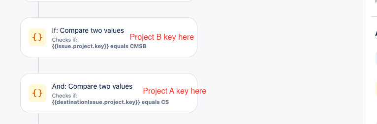

In order to help debug the rule I am going to need you to identify the projects referenced in the steps and the projects for the issue that are referenced in the execution log for the rule. You can paste "A" and "B" into the images.
What the log is indicating is that the issue considered the "source" in the link relationship if failing to match the first condition.
This condition should be checking that the issue considered the source if from the project where the issue has the "causes" side of the link. If the issues in Project A are linked to indicate they cause the issues in Project B:
A-111 causes B-222
...then the first condition needs to check that the project key equals "A", and the second condition needs to check that the project key equals "B".
The two issue referenced in the audit log are X-1821 and Y-12772.
The log is telling me that it considers X-1821 to be the "source" issue, which means that the link was created thus:
X-1821 causes Y-12772
Y-12772 is caused by X-1821
Since X-1821 is considered the source, and the first condition is failing to be met, that tells me that the first condition is not checking that the source issue is in project X.
Either the link was created backwards or the conditions name the wrong projects.

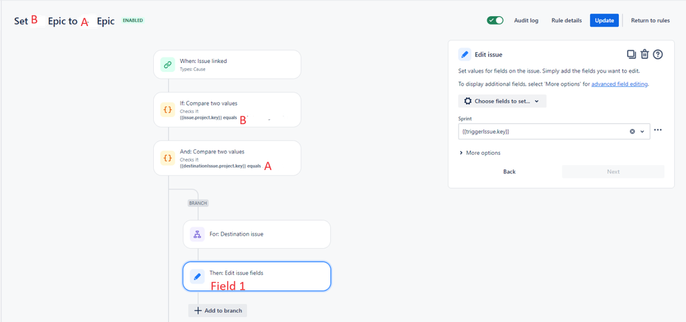

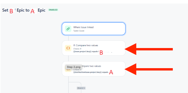

Parag Ahire March 22, 2024
Hello @Trudy Claspill  here are the screen images
Steps taken to test
a) Create Issue B-1 under Project B
b) Create Issue A-1 under Project A
c) While in Issue A-1 from Project A, add a link with "caused by" relationship and associate Issue B-1 from Project B (actual result Field 1 under Project A is blank; expected result is that Field 1 under Project A is set with value B-1)
d) c) While in Issue B-1 from Project B, add a link with "causes" relationship and associate Issue A-1 from Project A (actual result Field 1 under Project A is blank; expected result is that Field 1 under Project A is set with value B-1)
Note: Rule is created by a JIRA administrator as a Global automation rule.
Trudy Claspill
March 22, 2024
Can you provide the Audit Log execution details for (c) and (d), indicating which log is for (c) and which is for (d), and labeling the issues in the logs as from project A or project B?
Parag Ahire March 25, 2024 edited
@Trudy Claspill
Audit log for (c) above.
Audit log for (d) above.

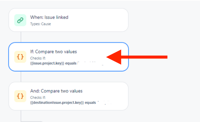

Trudy Claspill
March 25, 2024
Can you confirm that in the two conditions:
...you have used the correct project keys for each project? Note here you need to use the project keys, not the project names. The keys are the alphanumerics that appear to the left of the dash in the issue keys; i.e.
BBB-123 - key is BBB
AAA-456 - key is AAA
And also make sure that you have used the correct case. Project Keys are usually all capitalized.
You could insert Log Actions before these Conditions to print the keys into the rule execution log to confirm that your smart values are getting what you expect:

You must provide the Project Keys in the Conditions that I specified after the trigger. If you don't provide the project keys here you cannot limit the rule to executing only when the source issue is in Project B and the destination issue is in Project A.
You can add a check of the issue type for the trigger issue using a simple Issue Fields Condition.
You can add a check for the destination issue type using a Smart Values Condition.
That should satisfy all your requirements.
