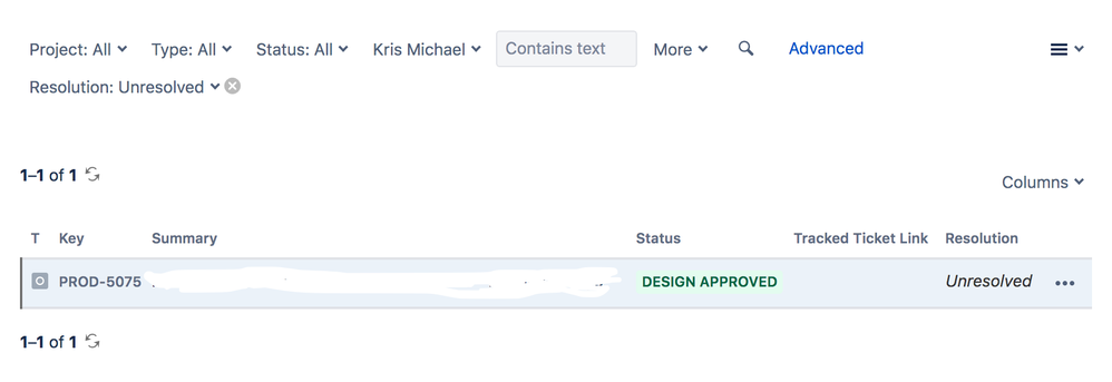

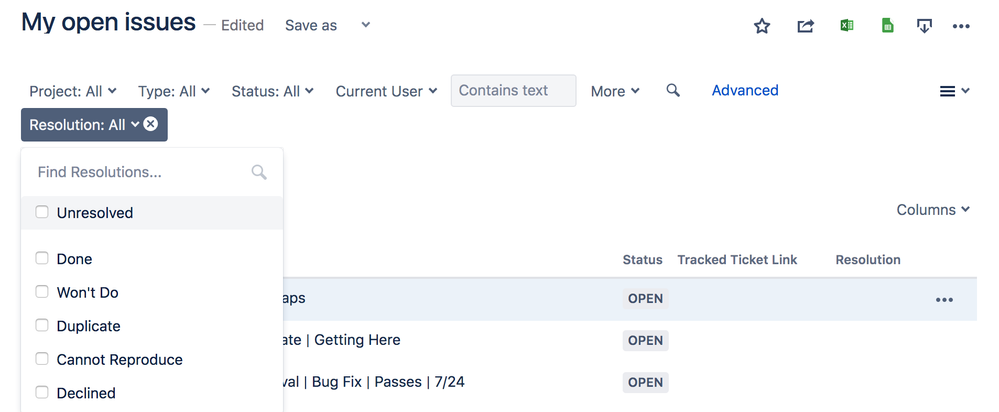

When I click on the "My Open Issues" filter, it brings up the Resolution filter as "Unresolved". However, none of the new issues I've created (all which have a blank resolution value) show up when I select "Unresolved". If I delete the Resolution value filter, all my issues show up. How can I get these blank resolution issues to correctly show up as "Unresolved"?

Could you pick on one of the affected issues ( Prod-5075 would be ideal, as we've seen its current state) and compare the issue view with a search view that includes it?  Then, more importantly, re-index the project and check the two views again?

July 22, 2019
Are you saying that if you uncheck that checkbox in the screenshot, you see issues with blank resolutions?  Can you screenshot an example of one?
Country Sam July 22, 2019
Yes. That's exactly the case. See the screenshot below.
Like Randy likes this
Randy
July 22, 2019
Seems like a bug with Jira.  Can you try adding the Resolved field as a display column and see if there's any value set there for those 3 issues?
If you look at the screenshot, "Resolution" is already a display column and no data is displayed in the column.
The "Assignee" filter has nothing to do with the issue. It all works properly and displays as it is supposed to. If I uncheck the "Assignee" field, it displays the several hundred issues assigned to other users.
Also, to note, the "Unresolved" issue only seems to apply to these new issues I've created as part of my new workflow. There's other issues that exist that filter correctly based on the "Unresolved" filter.
For example... see the attached screenshot. Other issues created through other workflows correctly show the "Unresolved" resolution. It has nothing to do with the Assignee of the field.
