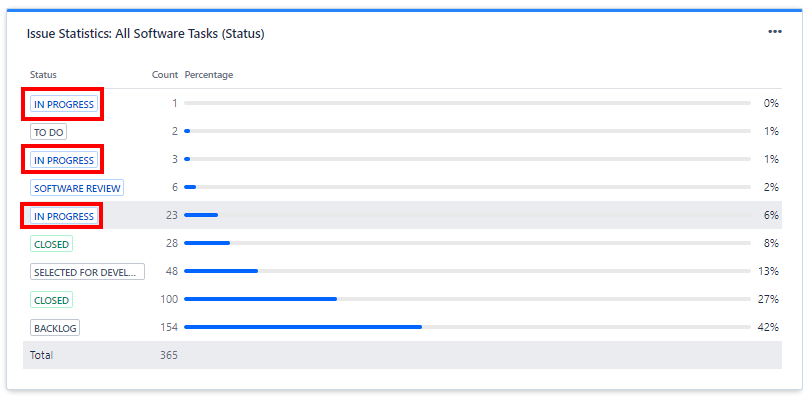

I seem to have created issues with the same 'status' name, but different status ID's.
Hovering over the lowest "IN PROGRESS" status brings up the tooltip for the build-in IN PROGRESS status. However the others dont have this.

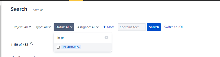

If I examine the available status options in the filter tab, I only see one "In Progress" option.
I also see only one "IN PROGRESS" status under Admin->Issue Attributes->Statuses
I would try to bulk edit these if they had different statuses, but from Jira's filter perspective, they ARE the same. However Issue Statistics shows them having some difference.
How can I unify these rogue statuses?

On further examination, this appears to be due to a mixture of Next-Gen and Classic statuses. So I suppose I could limit this issue statistics to only Classic Projects. But if possible, I would like to group the statuses with the same name together.

Hi @gmb1226  - This happens because Next-gen creates multiple versions of the same status (and custom fields, too!).
If you limit your filter by project that is used in the gadget, that should help.
But you can't just move the cards to another "In Progress" status because that might cause them to disappear off of the appropriate Next-gen board.
