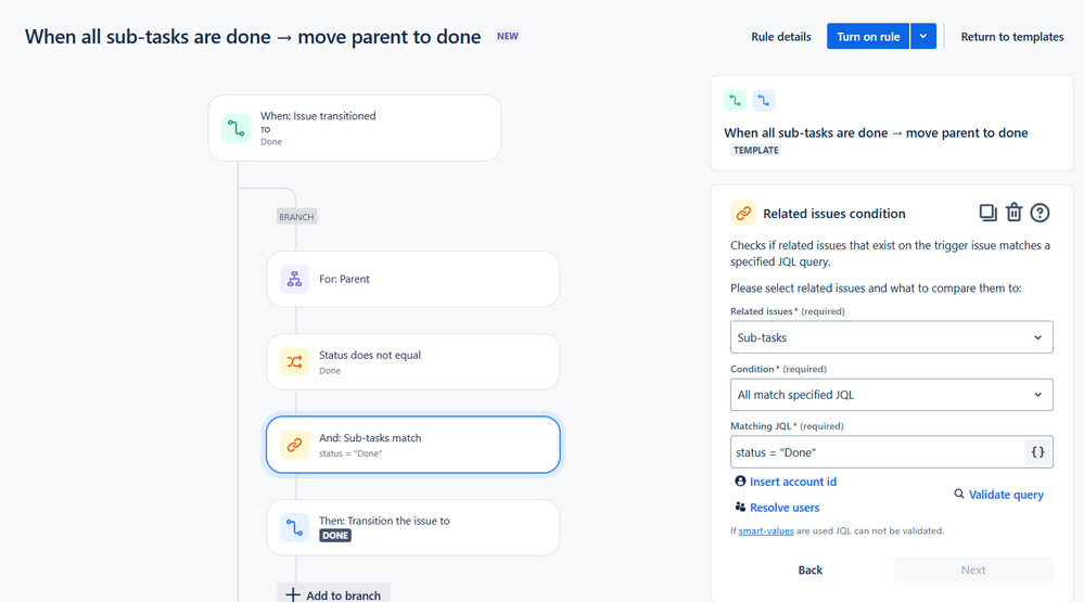

As per the Automation, the expectation would be for it to work as below.
1) Trigger
Once a Issue is transitions to "Done"
2) If the issue type is "Task" and then validate custom fields "Task Type" and "Approve or reject".
3) Check the parent issue of the Trigger
4) If the Parent status is not "Ready for Updates"
5) Check the related issues (Children) of the parent issue under the branch as per the JQL
6) Transition the Parent issue to "Ready for updates".
This is based on a Template (see attached).

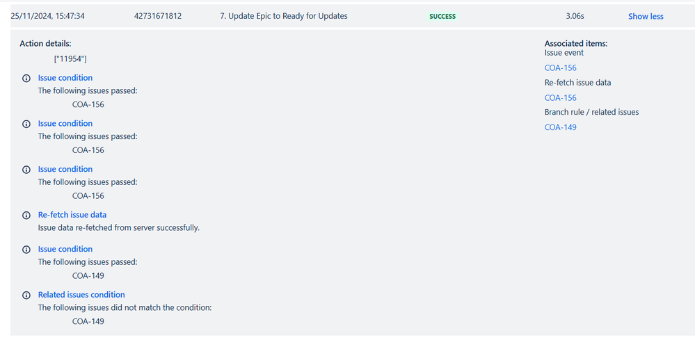

Bill Sheboy
November 25, 2024
Would you please repost the audit log details for the rule?
The image you show is not for the rule as the audit log shows a call to the Re-fetch Issue action and that is not in your rule.
Also please post an image of the Related Issues condition you are using.
Aslam Mohammed
November 25, 2024
I've uploaded the correct screenshot of the Automation which has the "re-fetch issue data"
Here's the JQL used: issuetype = Task AND "Task Type[Dropdown]" = "Approval" AND "Approve Or Reject[Dropdown]" = "Approved" AND status = Done
Here's the validation result of the JQL, which shows correct results.
