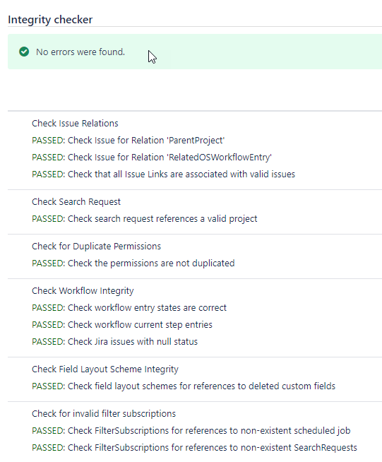

Randall Williams January 4, 2021
Daniel Ebers
January 4, 2021
The integrity checker would not be able to diagnose this kind of issue - to my knowledge.
Have you had a look into atlassian-jira.log if anything related to this can be spotted?
Daniel Ebers
January 4, 2021
There are some errors which I were not able to find a root cause for using knowledge base.
Also this one: https://confluence.atlassian.com/jirakb/jira-throws-nullpointerexception-in-issue-navigator-867013154.html
makes sense but in your case Integrity Checker is not able to find anything related.
