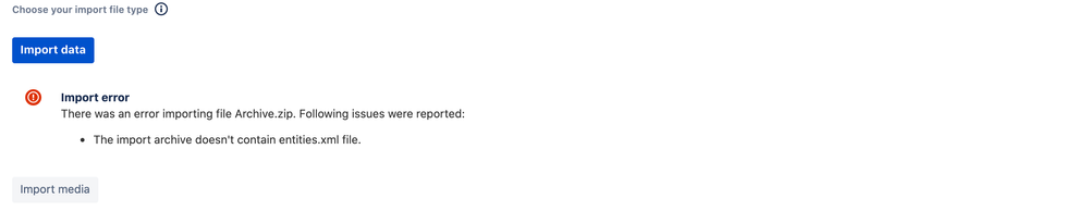

hmm. Backup manager got worked, but I got new problem now. External import from JIRA server XML backup is not working all of a sudden. Though the archive has entities.xml
I just tried again and it worked...perhaps I had a cache issue? I'll check my entities.xml for any issues but I'm not importing to server.... I'm refreshing a test cloud environment.
Okay @Dennis McCaie that's great - I believe there is currently issue going on from Atlassian side as multiple users raised same import issue on today alone. I'll follow up that on separate channel.

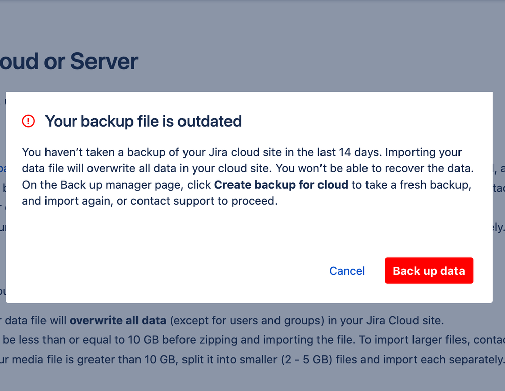

Unfortunately now when I tried to restore my backup to my test environment to test my merge it's telling me I can't proceed because my last backup is older than 14 and I must take a backup to continue. Unfortunately, I can't take another backup for 48 hours now! lol
Oh well...time to delete the Jira cloud instance and start fresh. lol
Yes that warning is wrong actually. May be that's the only way for time being.
