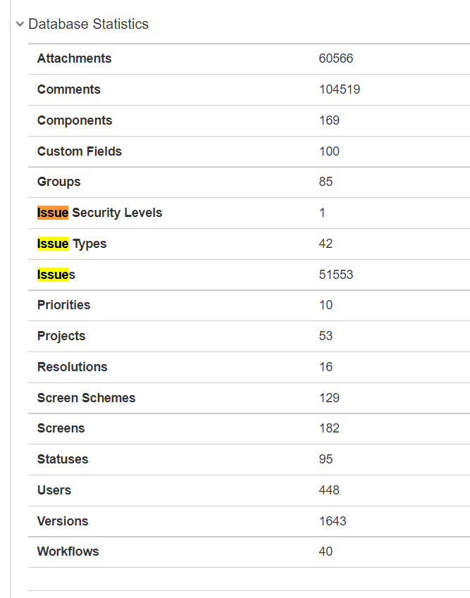

@willie My guess is that you will need to increase the memory. What are your instances sizes? (Jira and Confluence)
Jira
Confluence
To increase the memory is the only way? or Could I modify JIRA/Confluence Memory setting with Setenv.sh file for reducing memory?

Are you actually getting out of memory errors thrown by the apps? Your stats look healthy.
Or are you looking at the overall usage on the server?
With Jira, confluence and the db on one machine you will have high usage. You have 3 atlassian Have processes , the DB and the o/s and only 32gb overall.
The JVM params you have shared are reasonable
In the Jira system info page you can confirm whether they have been applied and see the current usage.
The garbage collection in the JVM will claim back unused memory. Are you seeing spikes? Try to identify what the apps are doing at those times. Backups to XML are quite heavy and not viable once a system gets very large.
@willie It looks like the heaps are fairly healthy. You have to understand that when you allocate memory to Java it will take all of it on the system and will end up managing it. Just because a lot of the memory is being used does not mean that the system is not running well. Are you having application degradation? Is the server crashing?
