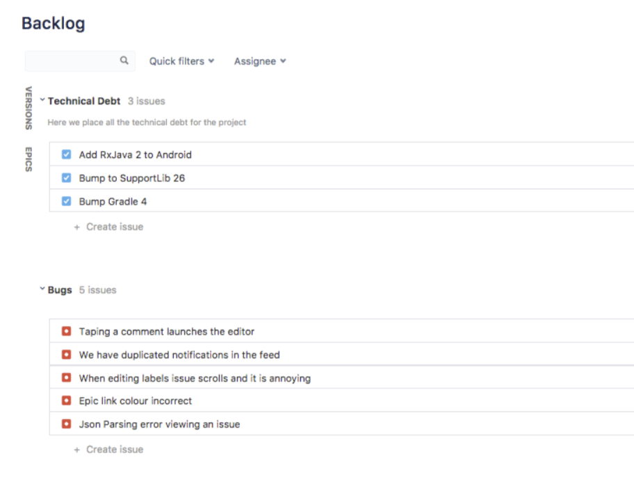

Hi @Nic Brough -Adaptavist- ,
I am new to Jira. I am using Jira Cloud for Scrum boards and Software projects
Here are 2 points
- I am looking for Group By because I wanted originally to group issues in the backlog visually based on certain categorizations such as short-term, mid-term, and long-term. Or maybe other categorization (Feature-request, Tech Debt, Customer-Request, ..etc.). I didn't find a native way in Jira software to do this. I have seen you replied in other threads that I can't add fields (or columns, whatever you name it) based on an attribute attached to an issue. So, I thought to do a JQL filter and group by 'label' as a workaround. Now, you tell us this is not possible as well. If you can help me in this, I would be thankful.
Update - I need to have something like this (but please don't tell me to create fake sprints, because this is short-and-dirty workaround!)
- Please try to understand customers' needs and requests. Honestly, I didn't like your blunt responses and replied in many threads. I mean it. You give customers harsh replies such as 'useless' or 'you don't need it'. Please give some respect to customers' needs. Even if we don't understand the product and you are the expert, you should help us achieve what we need, not educate us how to do work. As a product manager in enterprises for more than 10 years, I think that some responses you give are not the best you can give to customers. Don't' take it personally. I just see myself can't go silent while you jump from one thread to another shutting off customers just because they need a feature to manage their work.

I have read your answer 2 times and still can't find a way to do what I need to do.
Incredibly simple ask, how to categorize the backlog and show these categories visually in groups? Similar to the screenshot I attached in my previous reply.
I think it's a basic requirement, and as a new Jira admin coming from MS World, I wonder why this is not there.
We have periodic BL grooming sessions. Having issues categorized and displayed in groups is exactly what my team needs.
Is there a way to do it? If so, please tell me how
Like Teresa Lackey likes this
November 25, 2020
You would need to rewrite the screens and code that renders the backlog, and bear in mind that this would destroy your ability to rank the issues.

Brenden Eshbach
February 17, 2022
I'll be the first to back down and say that I may have misunderstood something here. @Nic Brough -Adaptavist-  is right, Group By is essentially useless in a function that returns a list, from the standpoint that Group By is primarily visual, i.e. you put these items here and these other items over there. So perhaps there are two requests here. My request was to be able to Order By Field 1, then by Field 2, then by Field 3, etc, which ends up "grouping" items with the same value in a field. If that is already possible, please let me know how to implement it.
For example:
Order By Due Date:
Ordered by Status, then by Due Date:
Grouped By Status (visual):
Are we on the same page now? If I understand this thread, at minimum I want to be able to Order By this, then this, then this. Some folks want the visual grouping. Both would be AWESOME!!
Like Nic Brough -Adaptavist- likes this
