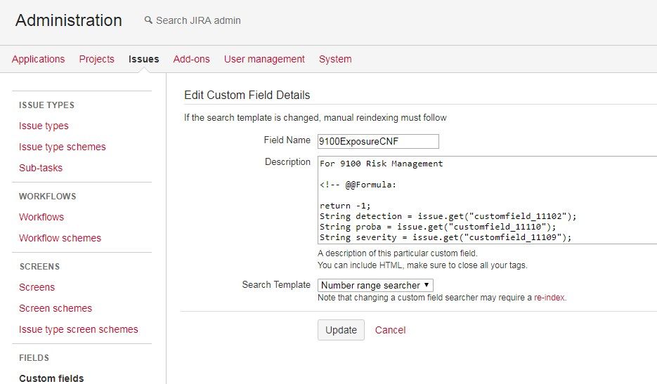

I encounter the same issue.
The description is the following
For Risk Management

The error in the log is followed by a URL. Did you try navigating to that URL?
Yes, but due to CAS in front of our Jira, the URL is not accessible directly.
Then adjust the domain name of the URL. That URL has to be accessible, otherwise you wouldn't be able to configure the custom field...
And does it show the exact same formula you posted? Can you post a screenshot of that page? And also post the full error with stack trace (right above the link)?
And the error is that the formula cannot be found for this field?
I don't see the end of the formula on the screenshot. Can you post a screenshot of that, just in case the formula isn't properly closed?
Can you also try to replace the whole description with a simple formula (in case there's a hidden character or something)?

The formula I have paste in previous message is the same ... No extra characters.

this error message is for a different field than the one in your screenshot (field "9100 Exposition" - customfield_11108). Did you navigate to the corresponding URL (masked_url/jira2/secure/admin/EditCustomField!default.jspa?id=11108)?
Also, depending on your version of JMCF, since you're using translated descriptions, you might want to try adding the formula to the translated descriptions.
