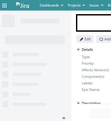

×We've recently installed the JIRA 9.9.0 on our new Windows server and configured the DNS with IIS as a reverse proxy. The project sidebar is loading fine when we use the local host as a base URL(http://localhost:8080), but the same is failing to load with the custom DNS via IIS. The below HTTP GET calls are raising Bad Request(400) error and it's preventing the sidebar to load and giving an error "We couldn't load the project sidebar. Refresh the page to try again". The issue started happening after we migrate the JIRA software from an old Windows server to a new Windows server. We've followed all the steps provided in the Atlassian article such as IIS Configurations, URL Rewrite, and Proxy Configurations but it's still failing with 400 errors.

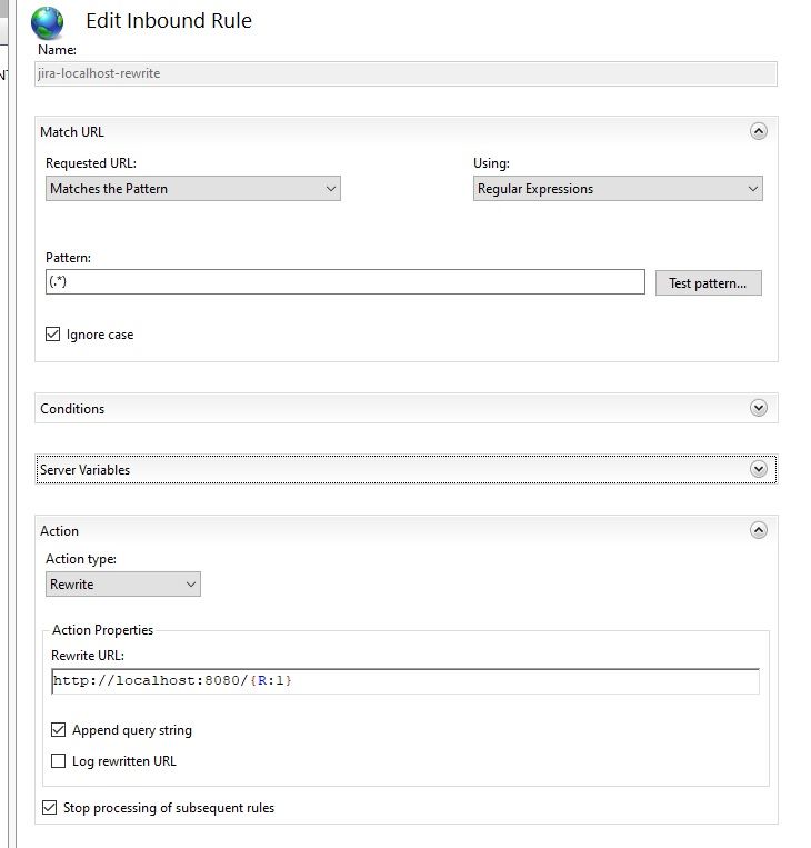

The UrlRewrite rules are currently present at IIS site level not at the server level. I've also verified the settings mentioned in the KB article and it's exactly the same. Please refer to the screen shot below.

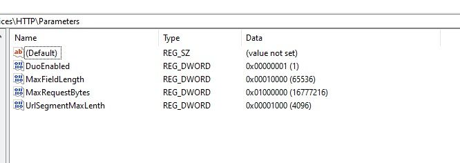

As per the article, I've created these new registry entries in the specified path as shown below but no luck.

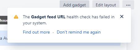

We've also received the below Gadget Feed URL error after rebooting the server today but it occurred only once and not after that. I've also checked the health check menu by clicking the Find out more link in the below image and it's showing the result as "Jira is able to access itself through the Gadget feed URL"

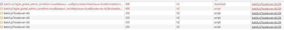

The below HTTP/2 GET calls are failed again with same 400 errors.
2023-08-04 00:33:27 123.2.2.1 58679 192.x.x.x 443 HTTP/2 GET /s/3608a30700ca957c8d29e1f7ab136a1a-CDN/-ew6rv8/990000/sd12uq/2b6b456a75fc97d4b250d9c86888a34f/_/download/contextbatch/css/com.atlassian.jira.plugins.jira-development-integration-plugin:0,com.atlassian.jira.plugins.jira-quicksearch-plugin:5,com.atlassian.jira.jira-frontend-plugin:84,-_super,-jira.view.issue,-project.issue.navigator,-jira.global,-jira.project.sidebar,-jira.webresources:calendar-localisation-moment,-atl.general/batch.css?agile_global_admin_condition=true&baseurl-check-resources=true&healthcheck-resources=true&jag=true&jaguser=true&jira.create.linked.issue=true&richediton=true 381 - 400 - URL - TCP
2023-08-04 00:33:27 123.2.2.1 58679 192.x.x.x 443 443 HTTP/2 GET /s/f8b5697645ab53c7701598af5f4b1577-CDN/-ew6rv8/990000/sd12uq/2b6b456a75fc97d4b250d9c86888a34f/_/download/contextbatch/js/com.atlassian.jira.plugins.jira-development-integration-plugin:0,com.atlassian.jira.plugins.jira-quicksearch-plugin:5,com.atlassian.jira.jira-frontend-plugin:84,-_super,-jira.view.issue,-project.issue.navigator,-jira.global,-jira.project.sidebar,-jira.webresources:calendar-localisation-moment,-atl.general/batch.js?agile_global_admin_condition=true&baseurl-check-resources=true&healthcheck-resources=true&jag=true&jaguser=true&jira.create.linked.issue=true&locale=en-AU&richediton=true 383 - 400 - URL - TCP

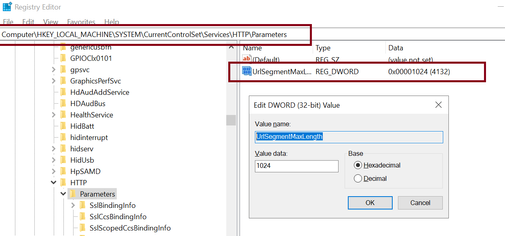

I've also gone through the StackOverflow article and created some additional registry entries as well but the issue still persists.

I was able to resolve this. You need to add "UrlSegmentMaxLength" value in Windows registry.
